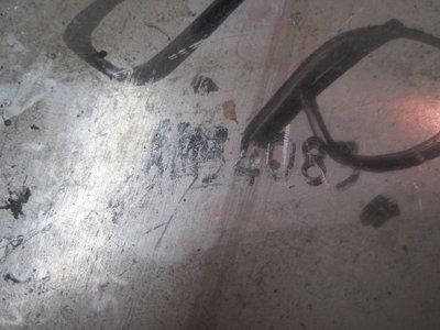

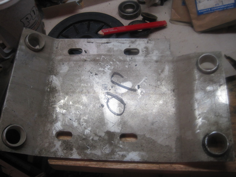

Anyone tell me what this engine plate is for?
Thanks

It appears to be a JD part number, but it does not come up as valid in JDParts.com.
That does not rule it out as a JD part. Where did you find that?
Might it be for a garden tractor?

I think "M" and "AM" are indicators of a sled part.

Both M and AM are still current in JD part numbers, not just sleds. M is always an individual item such as a bolt, and I believe AM indicates an assembly.

M and AM are current parts prefixes; AM is Horicon but M can be from anywhere.

Matt is correct. I have had that part in my hands many times years ago and can not for the life of me remember where it went. Remember I have had every base plate made in my hands from year one at one time or anouther.

I logged onto JDPOINT and the number subbed to M66864 which is the engine plate for the Dator. Hope this helps.

The parts department at my local dealer confirmed it is a Dator engine base plate.

Matt is also correct concerning the M vs AM prefix.
In the Deere parts nomenclature, single letter prefixes signify a bare part. Once anything is added to a part, for example a bushing or a bolt or a clip then the part # has an "A" attached to it signifying a part assembly.
In the good old days, the letter prefix meant more than they do now.
R and AR were Waterloo factory sourced, in this case tractor parts
E and AE were Ottumway factory sourced, in this case hay tool parts.
H and A were Harvester factory sourced, in this case combine or crop cutting parts.
and so on.
M and AM are Horicon factory sourced. However, recall that long long before lawn tractors and snowmobiles came on the scene, Horicon was a grain drill factory. Deere chose to convert it from drills to producing their new line of lawn equipment. Hence, many older M and AM parts have nothing to do with Deere's Consumer Products. As a very general rule, if the part #'s a low five digit or a four digit then it's likely not a lawn tractor or snowmobile part. To add further confusion, Deere's Dubuque factory built tractors, such as the model M, 40,320,330,420 and 430 all carried M and AM part #'s with, again, being mostly lower 5 digit or 4 digit part #'s. These Dubuque part #'s later were changed over to T and AT prefixes when the new Industrial products began to emerge.
Also factor in that Deere's bicycles as well as chain saws carried M and AM part #'s that look to be correct for lawn tractors or snowmobiles and you can see there's no hard and fast rule. You have to do your research.
