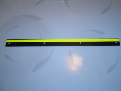

The steel strip that holds the snow flap on has been freshened up, progress comes in small increments.
It took a lot of heat, but the skis, spindles, and springs were separated. The pivot bushings were corroded solidly into the spindles, and the rear pins into the skis. A 2' piece of steel tube has been purchased for bushings, along with some aircraft grade bolts.

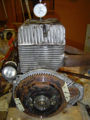

I had tried to time the engine last spring, but found I couldn't get a good signal from my test light, so I walked away until this last week. After installing new aftermarket points, and giving them a swipe with 600 grit, I had a good signal, so timing could continue.
Apparently I tend to set the points a bit tight. Both sides were between TDC and the specified timing point ( .023 ).
I got half of that turning the breaker plate, the rest by opening up the points.
Here's the whole set-up:

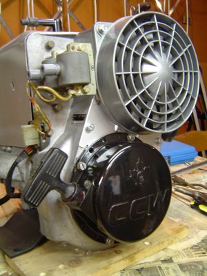

Work continues with the fan tower and recoil installed. New bearings, new belt. The fan guard appears to be NOS, but I can't recall where I got it. I need to get some wires on it, and check for spark.

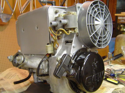

The engine has been pretty much finished up. Plug wires and caps were installed, and a pull of the rope shows spark on both sides!
That was gratifying, now onward and upward!

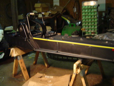

Well, it's been 5 years since this thread was started. A lot of water has went under the bridge, but this sled is still sitting in the middle of the shop collecting dust. The 440/21 has been powering the wife's green machine for 2 seasons, and most of the parts for the sled are refinished and sitting in the basement. This needs to go forward so that other projects can happen...so here goes!

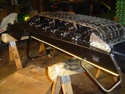

The tunnel has been rattle canned Blitz Black. The chaincase is in, and the stripe has been applied. Time to flip it over and install the drive train!

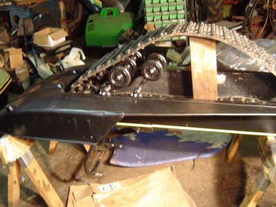

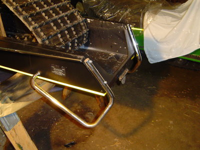

We flipped the tunnel over Saturday night, and the first thing I did was toss in the NOS Gates track. Dustin Elder has commented that he has installed driveshafts at least twice without the track installed, and while this greatly simplifies the shaft install, it is a wasted effort without the track in place. This is the last NOS track I have and I considered putting a few picks in it, but in the end I decided I just could not drill holes in a 40 year old NOS part.
I considered adding an idler wheel between the track drivers on the shaft, but I removed it before the installation. We are running the black drivers that were used on the cleated tracks, because the white drivers used on the bogie tracks are all cracked, whether they are NOS or used. The concern is that the idler, while supporting the track ( and matching the 3 idlers at the rear ), might just reduce the contact pressure on the drivers and make ratcheting a bigger issue. I would like to try it, but the downside is all the work to remove it if I am not happy with it . So I just took it off.
So, the grab bars are on. The driveshaft is in as far as the stuff to do on the underside, and the first 2 bogie shafts are installed. I am using stainless carriage bolts and nuts on the bogie retainers, as the original JD logo fasteners were ratty. I had a set painted silver, but decided to go stainless.
- Posts: 5611
Re: The last update
OK, the track and suspension are in! Rainville had set me up with a set of the correct slot head countersunk screws that hold the bearing cups onto the pivot plate, so the philips head ones were swapped out. Most everything in the rear suspension parts are NOS ( not including the axle and idlers ). The bogie tubes have new plastic bushings in them, while the tubes and related hardware were cleaned and painted. About ready to flip it onto it's feet, and continue from the top side.
