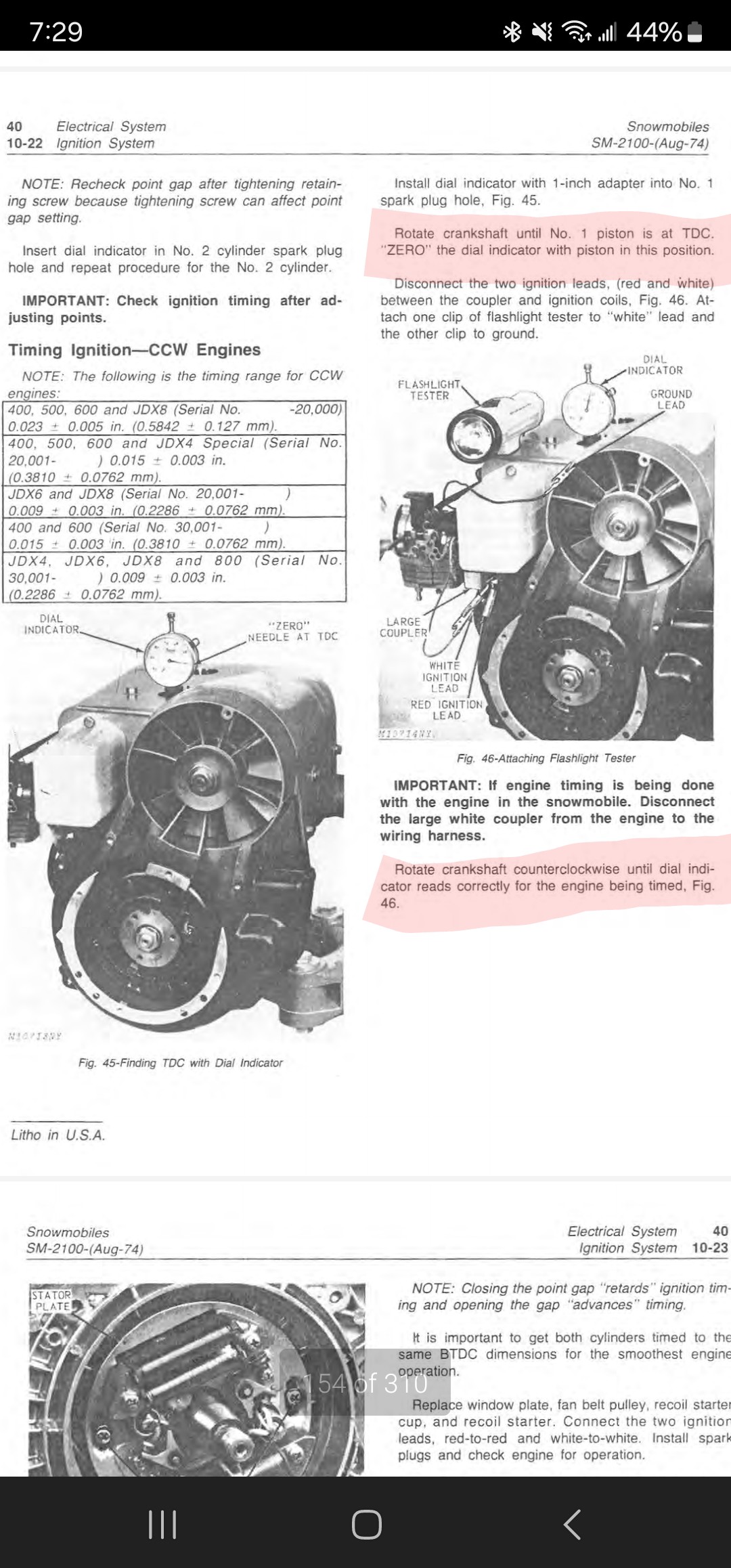

It's the manual with 310 PDF pages... Service manual SM 2100 from '72 Deere's serial numbers 2551+
Edit: found it again. Page 153 of the PDF... Section 40, 10-21.
Looks like I set the timing but NOT the breaker points. Yes, appears breakers need to open to a max spec of .014 inches (3556mm)

But, during this swap I found one of the screws holding the point had loosened, causing contact and no firing spark plug. So that was easy. I'm now armed with thread locker. What isn't easy is understanding the user manual on this... Find TDC, rotate the flywheel clockwise slightly, then this point your piston is should be what you rotate your stator to.
Something Steve said last year about his Kohler just hit me. I've always been looking at the tick marks on the flywheel, especially the one one marked "T" trying to line it up with a mark on the casing, which is probably just a casting imperfection.
Is the position of the piston for my 400 supposed to be .023" as read from my dial gauge (yes, I'm in the first SN grouping on the chart)? That would mean I've been interpreting too much verbiage and not enough of the tolerances provided in the manual.

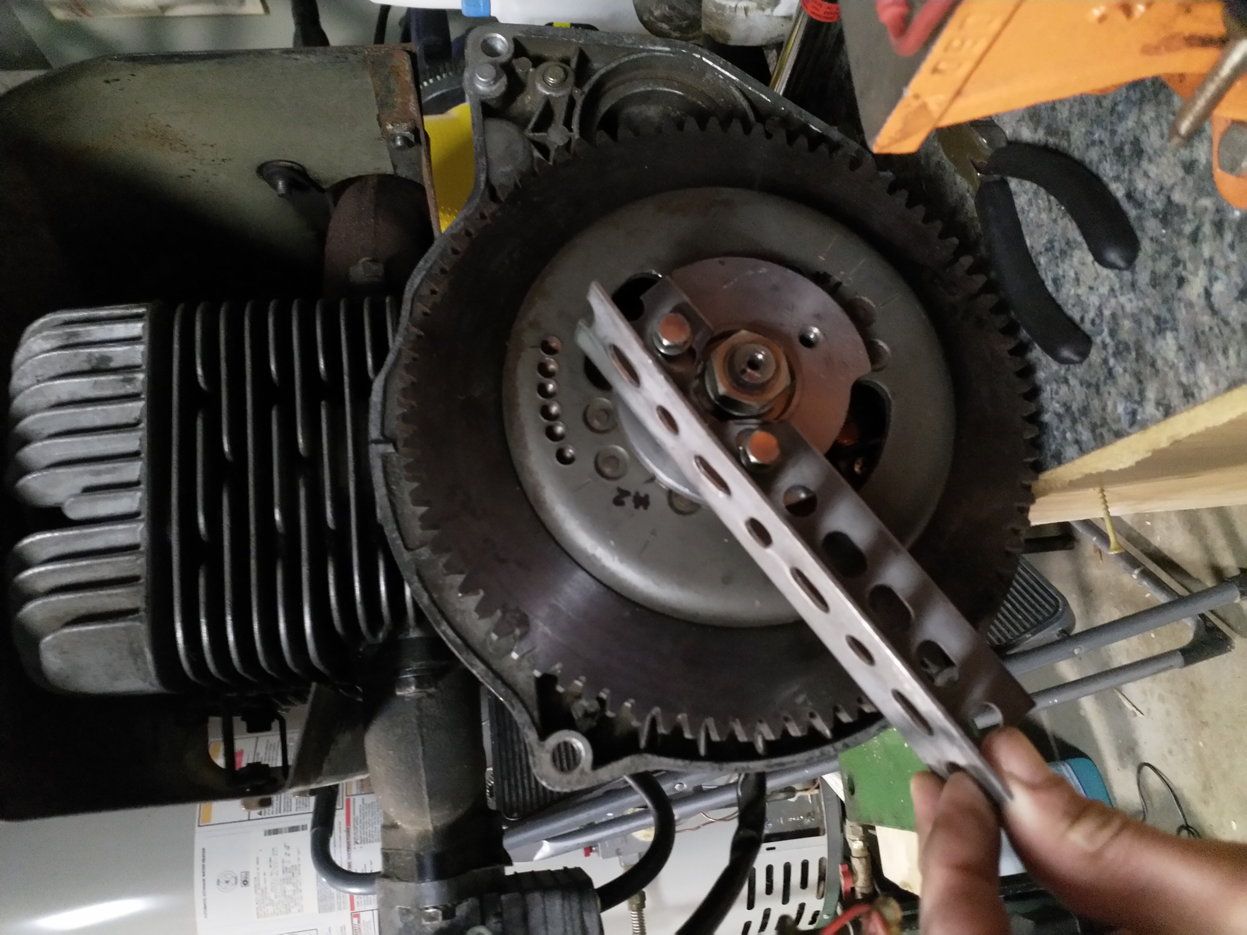

Impact driver removes nut, this scrap piece of angle from the box store holds it so I can torque it (leave your handle longer than mine)

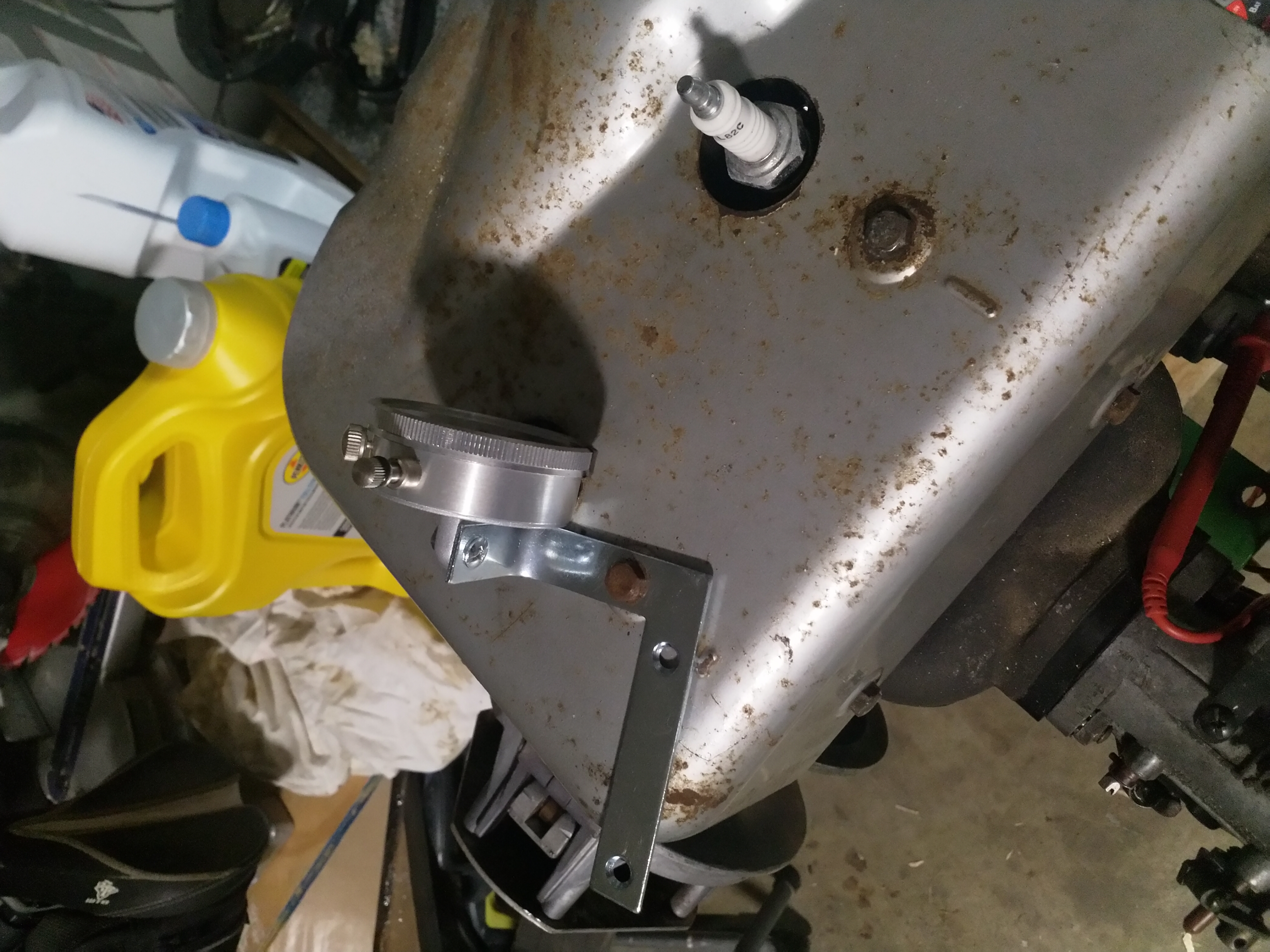

Overall setup
Overall setup

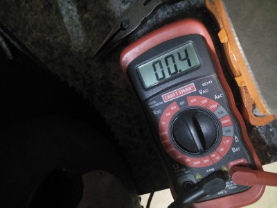

.02 - .04 reading when points are touching
.12 - .13 reading when points open

Took a frame angle bracket to make the holder for the the harbor freight gauge

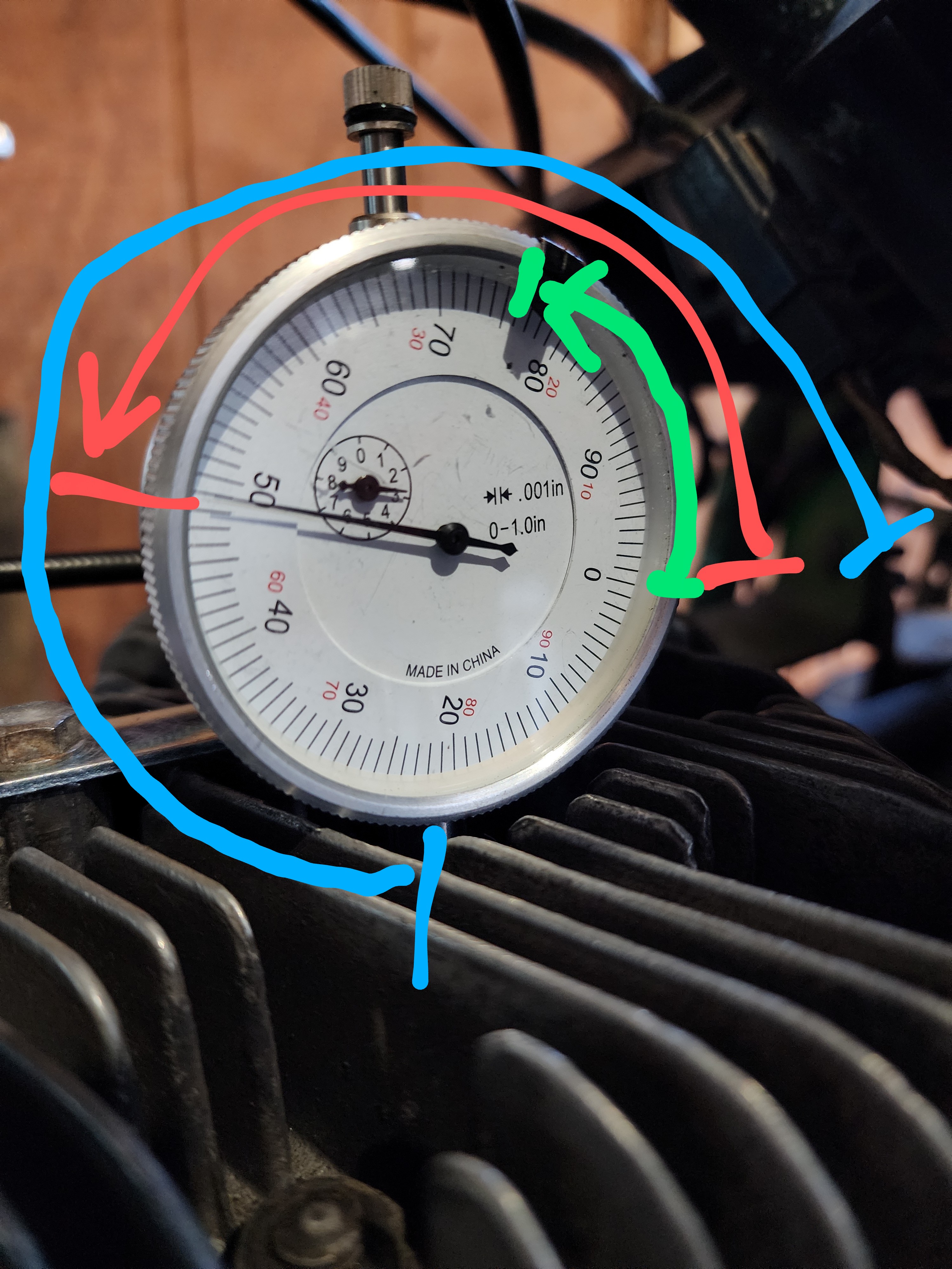

I'm still messing with this thing... It very well could need new coils, but I want to make sure it's firing when it should. Manual says to find TDC, rotate counterclockwise to specs listed on chart. My specs are .023" +/- .005. Am I supposed to rotate it only .023 (green line) or to .023 (blue line)? The red line indicates as far as I can go before the points close (by rotating the stator), so I can't actually make it to .023". Unless I'm reading the dial gauge incorrectly. I'm using a multimeter Ohms setting to find the exact point that they close (again, currently the red line).
