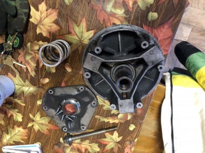

The only trouble I had on the 800 was the return trip from Lake Tomahawk on Thursday's practice run. Right before we got to the Hall of Fame, it would die at intersections. I could get it started again, but would take off right away which indicated a clutch problem of some sort. Then about 2 miles from our cabin at Fath's it quit and I could not even pull the rope. Looking under the hood, the belt was halfway down the secondary, and the primary was closed and would not open to let go of the belt. We loaded it on David's trailer and got it back to work on it. David had an impact, so we took off the primary, and found out that somehow the moveable face bushing worked its way out, and I was able to pull the locking ring out as it was just hanging there. I have no idea how that could jump out of the recess in the face, but this caused it to lock in high gear and not let go. So that clutch was shot. Luckily Wade was done using his 400 for the trip, so we pulled the Comet off his and onto my 800. It worked good, and seemed to shift nearly the same, so the spring and weights must have been similar. Got me back on the trail anyway.

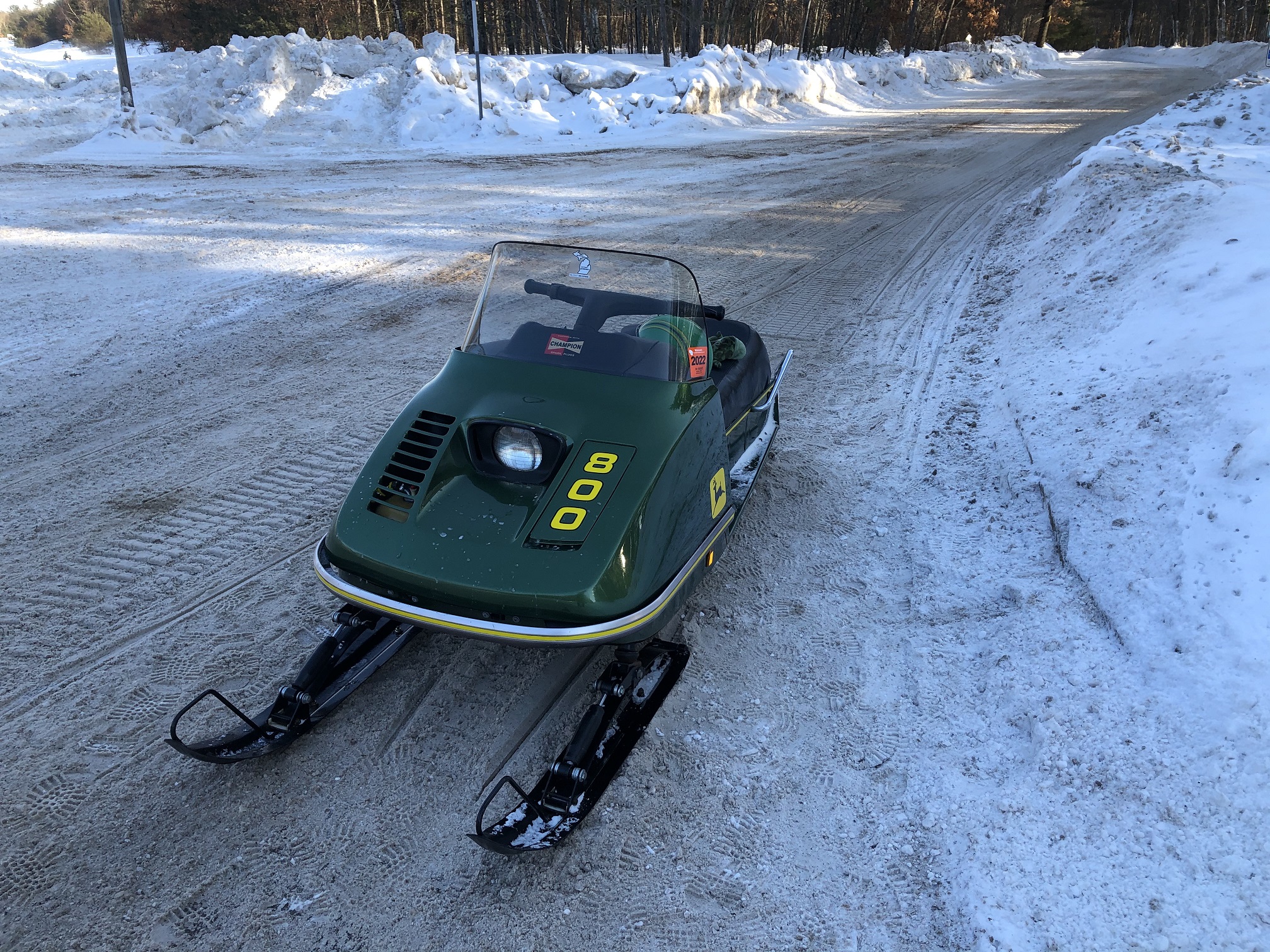

The first picture is where the sled died about 2 miles from the cabin.

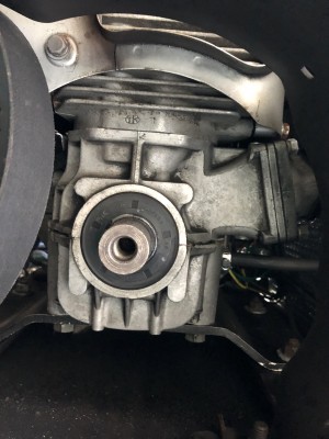

The good news is I believe all the issues I've had with this engine seem to have been alleviated for the most part, as it has been running cooler on the trail... I don't believe I'm fighting any more air leaks, and I took a photo when we popped the clutch off, which shows a very clean seal, and not a drop of oil anywhere. I think the rebuild and sealing the engine was a success.

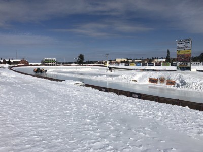

Decided to stay a couple extra days at St Germaine seeing as we are 1160 miles from home and 1900 miles from Phoenix which we left the warm weather to precipitate in some snowmobile events which started in Elk River. Because of the excellent snow conditions and favourable weather for snowmobiling wanted to get in some extra riding , Because everyone else is gone home and couldn’t find anyone else to ride with decided to take the chance of not getting lost or breaking down while riding alone.Feb 17/20 Eagle river was the Destination to check out the race track. Wanted to stay as close as possible to the highway so I took the southern route starting out on the powerline trail. Made a wrong turn if I remember right it was on the bohemian loop trail and ended up back in St Germaine. No big deal but appreciated even more when following someone Who basically know where they are going and where to turn. Eventually made it to Eagle River and racetrack and saw a Payloader preparing the infield of the solid ice track for the up-and-coming Races February 29 -March 1. Checked online to see what kind of races they would be running and was surprised to see that as young as six-year-olds would be racing Snowmobiles with Briggs and Stratton engines.
