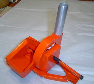

When we built the farm set for the grandson for Christmas, one detail that I included was a fill pipe up the side of the silo. By the next day, he was telling me that he was going to need a blower. I looked into that, and it appears that no one ever made a 1/16th scale forage blower. This meant that grandpa was going to have to build one!
Around the farm, I had access to a late model Case-IH, an old IH, and an old JD and Case that was built by Kools in the 70s. After looking at the 4 designs with an eye towards replicating then in 1/16th scale, it was obvious that the Case would be the easiest to build.
I had been thinking about this ever since Christmas, and a design slowly began to take shape. I took extensive measurements in March, and began collecting parts and pieces. The frame would be bent up out of .040" aluminum, and the rest would be a mix of pine and .012" aluminum. The hardest part was finding wheels that I liked. I finally got some plastic wheels with bearings that were for a 3D printer, that were the size I needed. I couldn't find the period correct decals, so I had to make do with decals from a 1/16th tractor from the 80s.
As always it was a scramble at the end. The toy was painted the night before his birthday, and the decals put on just before we left for the party.
He was very happy with the result.

A work of art, wow well done!!
- Posts: 1035
- Location: Roblin, MB
Re: Grandson's birthday
Nice Work, Brian! And that is one very happy grandson you have there.
