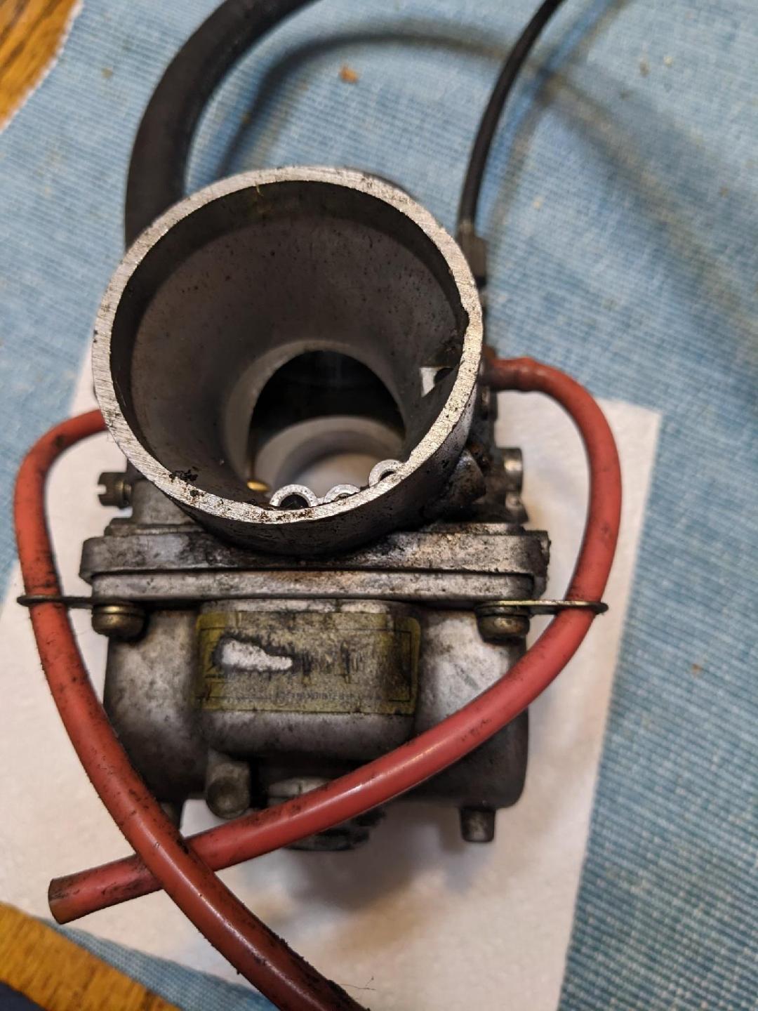

In the ongoing saga of the 76 Cyclone refresh…
We took the sled up to Bergland, MI in January to get into some better testing conditions, and rode up to Lake of the Clouds. The sled didn’t perform any better after it was up to full operating temp, and a couple tanks of gas ran through it.

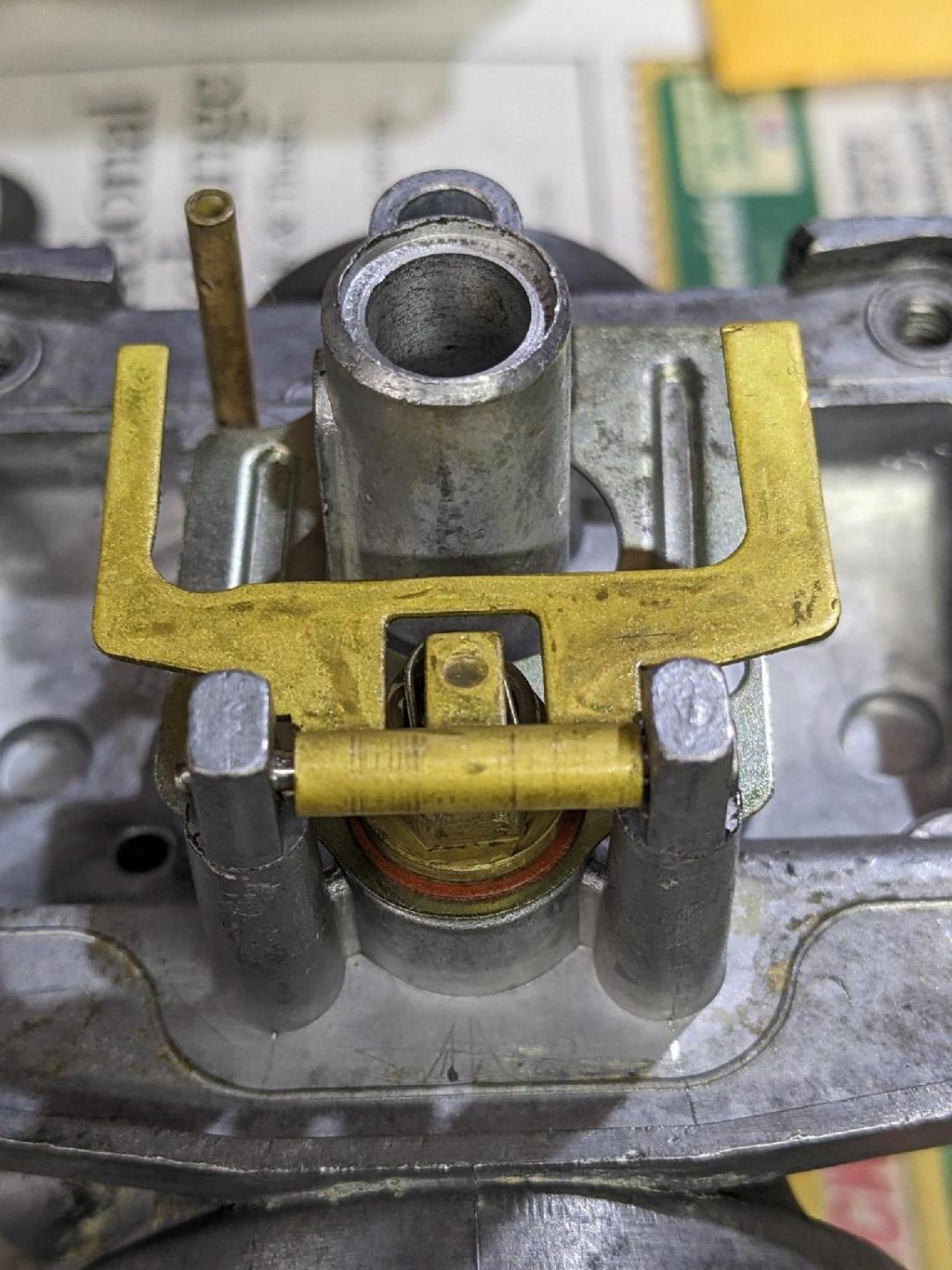

I felt I was seeing two different issues, and I was trying to sus out what exactly was going on. The plugs were running black, the sled was smoking, and the low end throttle response was terrible. Classic symptoms of running rich, but the carb had the factory jets sizes in it. Also, the sled topped out at about 40-45 mph, and it just didn’t give you the feeling it wanted to go faster. The rpms were 7k plus, which I felt was excessive.

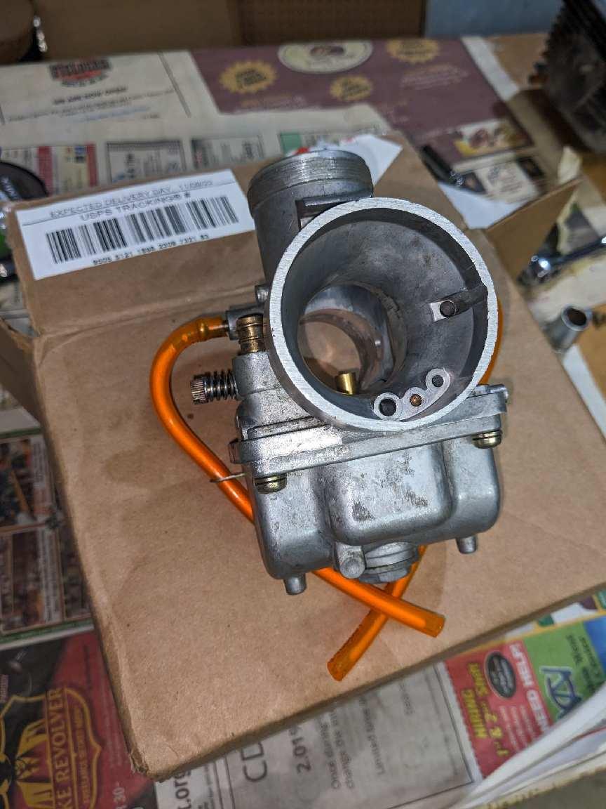

So when I got home I dug through the Cyclone parts box, and pulled out the first carb I laid my hands on. It appeared to be a 77 carb as it had dual vent tubes on it. It was very clean looking and had a black and yellow PN sticker on it. I took it back to the garage and proceeded to disassemble it. The part number sticker did not have a number on it, when I wiped it cleanI saw that it said Cyclone on it, not at all what I expected. After removing the enrichener plunger, I was pleasantly surprised to see a like new plunger and a very clean smooth orifice in the bottom of the bore. This seemed like a win.
After looking through the parts book, it appeared the main differences between the 76 and 77 carb was a different slide, bigger main jetting, and no air jet in the throat of the 77. The carb body itself had the same part number. One thing I noticed when I took the fuel bowl off was that the float arm was installed upside down. This meant that it hung nowhere near the level position it is supposed to.
I cleaned the carb, replaced the solidly plugged 20 pilot jet with a new one, ,installed the float arm correctly ( there are no marks on it indicating it had ever been installed correctly ), put a new 76 correct 370 main jet in, and put new vent tubes on.
I installed it back on the sled using the original slide that was connected to the throttle cable, put the fuel line on, then spent way too much time wrestling the air box boot onto the thing. I fired it up and got the slide stop screwed in enough so that it would idle, blipped the throttle a few times, and decided it seemed like an improvement.

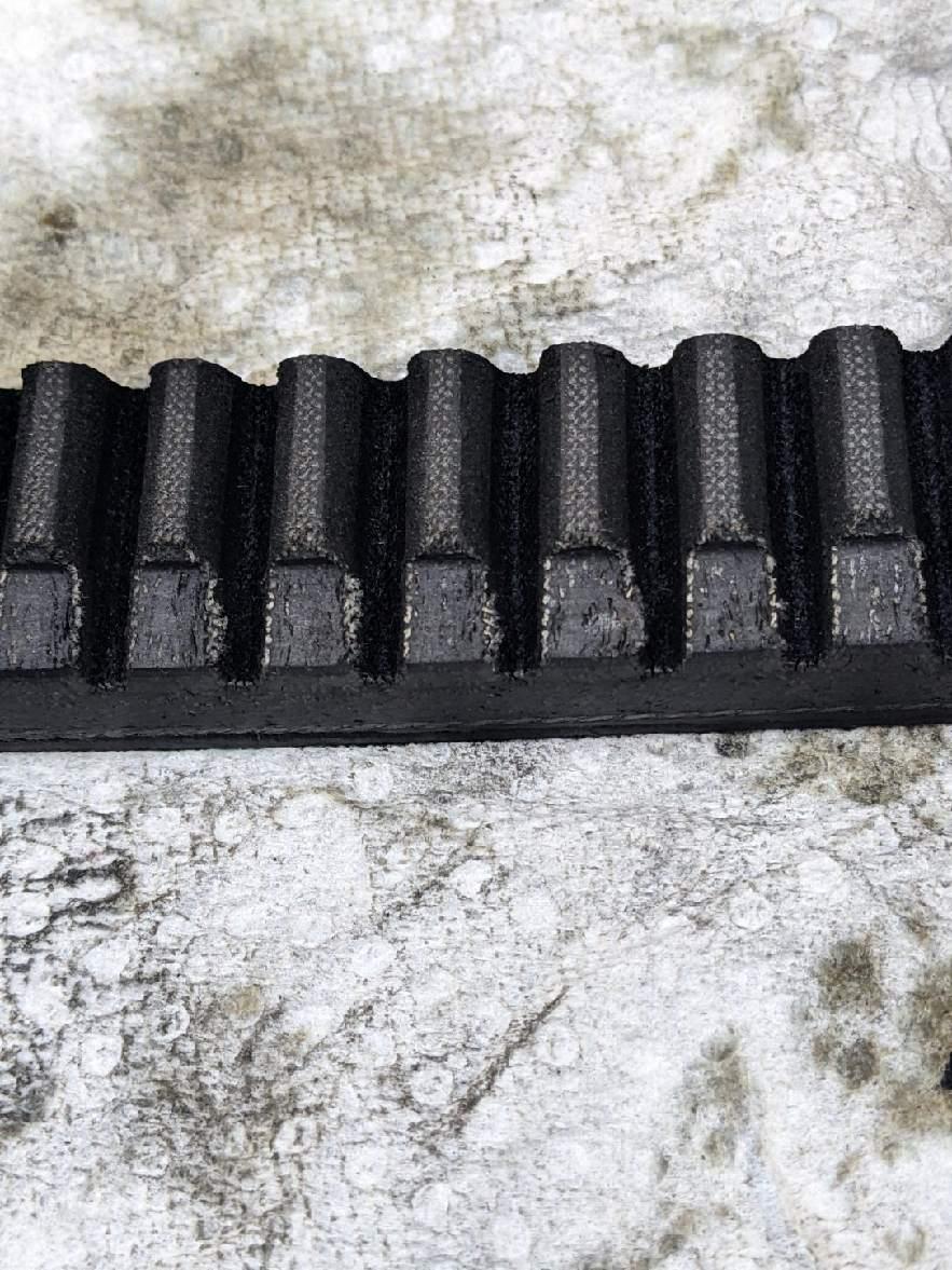

Yeah, I noticed this strange groove worn in the drive belt that had only 100 miles on it! This needed to be investigated, so I removed the belt and the problem was immediately apparent.
The duralon bushing in the moveable sheave had relocated itself. This meant the clutch was coming off!

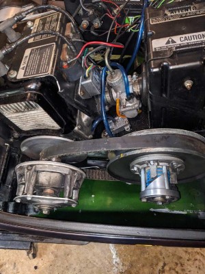

I grabbed the clutch puller, my cordless impact, a couple of sockets, and went on a clutch mission. Everything went good, and I had a 76 and a 77 102-C Comet clutch in the truck and headed back to the garage.
These two clutches are set up a bit differently according to the parts book. Different arms and spring. The 76 has a can on it, the 77 is open. The rollers were shiney on the 77, and the fixed shaft wasn’t horribly rusted. The cover bolts on these are Loctited on, and I didn’t have my propane torch at hand, so the 77 was going on.
I cleaned up the sheave faces, and removed the worst of the rust on the fixed shaft. Lubricated the arms and rollers, cleaned the bore and the crank stub, and it was ready to go on. I cleaned some of the belt dust out of the pan, I had spent quite a bit of time cleaning this thing last summer, already it doesn't look much like it.
I sat and looked at the thing for a bit, finally decided it was now or never. First thing that was different; I had to choke it to get it to start, and had to flip the lever a couple of times before it settled down and idled. I ran it out the door and let it idle while I got some gloves on. I jumped on, squeezed the throttle, and got underway. So far so good, throttle response was much improved. I rode around a bit to warm it up, then finally squeezed for effect.
My, My, My! I have a totally different machine. Put it to the bar and the speedo is heading for 60 mph right now! Our snow conditions are better now than in January, but not by much. The trail is thin and rough. Also they are closing the county trail system in the morning due to coming warmer weather.
