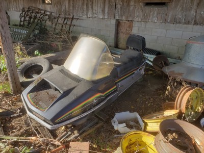

So back in Nov of 2020 I’m at work and my boss tells me that he purchased some farm stuff from a guy that had passed and while he was there he noticed a Liquifire sitting under the lean to on the side of the barn. He was going to pick up some more items he had purchased and asked if I would like photos of the Liquifire. At the time I had been seriously questioning my sanity with this hobby so my response was something along the lines of “it’s probably another 80 and God knows I have enough of those.” He was persistent about sending me photos and said “If you’re not interested, I’m sure you could help the family find it a new home”. He mentioned that the family was trying to clean up and it could probably be purchased for a song. So one Sunday I’m sitting in the recliner and this is the first photo that comes through as a text message.
This immediately caught my attention because I have always wanted an 82 Liquifire so I spent the next few seconds anxiously awaiting additional photos to download in the text message. So after a short while I received several photos and realized this one is a little rougher than I would like it to be, but what the heck I should go look at it.
I replied saying that I would like to take a look at it, already had my coat on and the truck keys in my hand. Then he replied stating that “we could stop someday after work" because it was very close to where we work. So now that I felt like a kid on Christmas that wasn’t allowed to open presents until my siblings wake up……..what else would I do……start sending these photos to my brother. A few days earlier I had told him that I was expecting photos of a sled so about 10 seconds after hitting the send button my phone was ringing. Right away he says…..you remember that sled don’t you…….ummmm…no. It wasn’t until he told me to look closely at the stripe on the hood that things started to come back to me. If you look closely, the decal had been damaged and someone painted the missing part of the decal on the hood. As it turns out this was the very first snowmobile that I attempted to purchase which would have been the fall of 1996. At the time I didn’t have a clue about Deere sleds other than as a child a family friend would stop by occasionally and give us rides on their new Trailfire, so naturally I wanted a faster sled…..insert Liquifire.

For some reason my boss insisted on handling the arrangements for me to look at this sled, but like I said I was 99.9% sure I knew where it was located thanks to my brother’s keen memory. After several excruciating days we stopped to take a peek. Sure enough, he was right. It was Kevin's sled. Like I said in 1996 I didn’t have a clue what a HSR or TR-800 was, so I didn’t recall if these were there when I last saw it in 1996. After closer inspection this 82 was very complete, including e-start, and the motor was free. This sled's downfall was that somewhere between when I had last seen it and this November day, it had been moved under this lean to where it was partially exposed to the elements. Kevin’s sister-in-law was handling the details and evidently “a song” turns out to be what I would call fair market value for a sled in this condition. It was too late though, the allure of HSR, TR-800, and e-start had a stranglehold on me.
I will admit that on the drive home I was somewhat excited but at the same time thinking why am I doing this (especially since the boss lady wasn’t informed). I have a strict no mouse policy when it comes to the shop so I backed the truck up to the shop and was expecting to have Larry help unload the goods and de-mouse it. As my luck goes he was with my wife and as I’m getting out of the truck I see her car round the corner. My phone immediately rings, I see it’s the commander…….ugh…..I have to answer now. Needless to say she was not impressed, my penance…….Larry was not allowed to help unload. So this fine specimen of an 82 would have to wait on the truck until the mandatory waiting period passed. Thank God I decided to take the spare truck that day. Three or four days later I enlisted her brother’s help to unload. Ain’t she a beauty Clark!

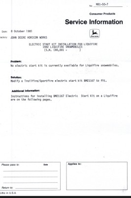

Looks pretty good considering the history. I didn't think electric start was available on a Liquifire until 1983 and it's not included in the literature for 82.
- Posts: 1111
Re: Kevin's Liquifire
I have always had the impression the 82's came from the factory with the ring gear and crankcase cutout. I do have a service information sheet which details the installation on the 82's.

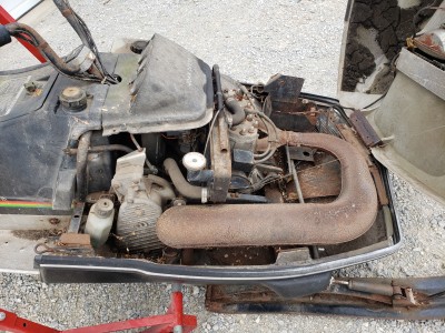

When Larry had an opportunity to inspect the sled he immediately noticed several things that I had missed. His first comment was “why does it have one 80 ski and one 82 ski”, this is something that I totally missed. Consequently the 80 ski is on the same side as the damaged decal. The second thing he noticed was a patched TPR panel at the nose of the sled on the left side, again, the same side with the 80 ski. At the time we sort of shrugged it off and put it on the lift in an effort to get the motor out and on the healing bench.

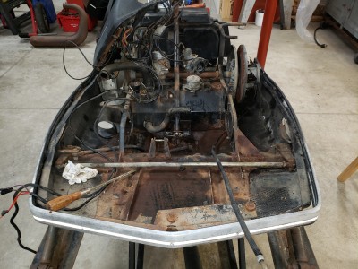

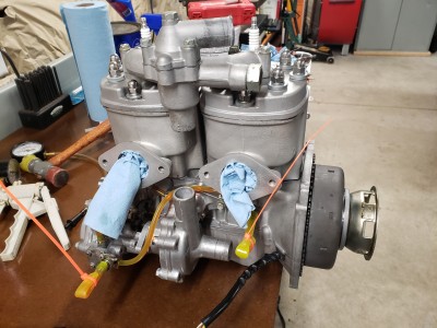

Extracting the motor went well and in no time the motor was on the healing bench. However, once the motor was removed some ugliness was apparent. The bottom of the belly pan had taken a hard hit at some point. It was pushed up to the point that there was not much room for the steering to move. Also the years of wet “stuff” under the motor had taken a toll. The result was some pretty heavy rust pitting under the motor and battery box, but no holes and the metal is solid. It was hard to identify but my assumption is the wet “stuff” we removed was years of decomposed hay or straw (most likely contaminated with hantavirus). Inspection of the steering column revealed that someone had been here before. The aluminum bracket had been welded where the steel column passes through it. My guess is that all of these things are related, I would love to hear the story behind this but it is most likely lost to time now. Even though the weld appeared to be holding, this was a no go for me. I wasn’t going to take a chance on this, so we were going to need an 82+ column.
We then turned our attention back to the motor. The plugs were removed and cylinders oiled. We rolled the engine over by hand a few times and then connected the jump box as a power source. To my surprise the e-start motor was alive and we had strong spark out of the HSR.

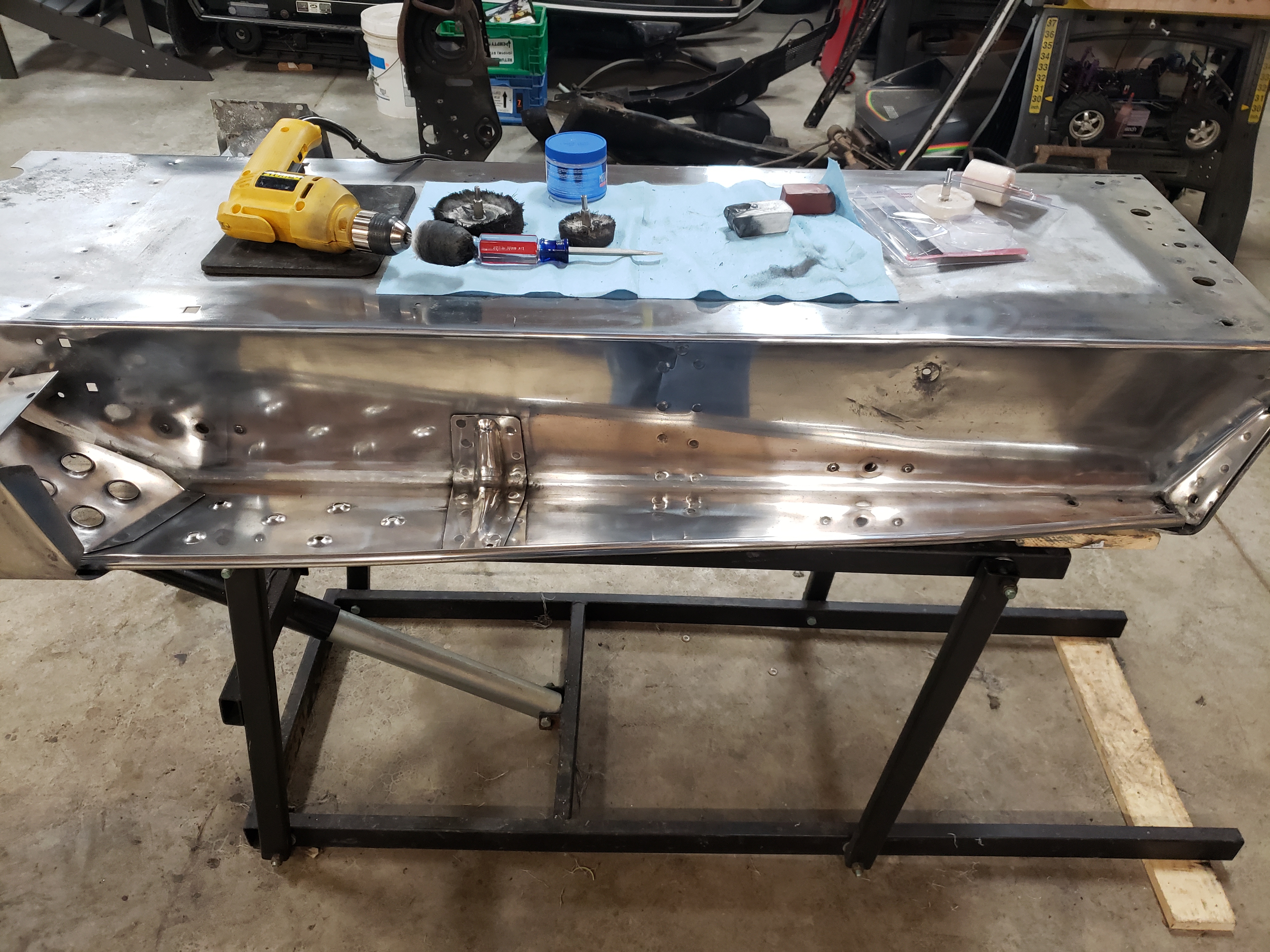

Once I was finished with the golf cart project, 4H, fishing trips, family vacation camping trip at the lake, camper winterization, in laws boat winterization / trailer wheel -brake rework, and a nice round of COVID it was November of 2021 before I was able to get back to Kevin’s Liquifire. I had the motor complete for the most part so we put that aside and turned our attention to the chassis. The goal was to completely disassemble the sled and gather all of the steel parts in anticipation of having them sandblasted in the spring so they could be primed and painted.
All I have to say is that you guys that always separate the bulkheads and tunnels are animals. I’ve drilled my share of rivets but I found these to be very difficult. As I kept drilling I was thinking to myself that these are not your typical hardware store rivet. After several days of searching I discovered that these are known as structural rivets, specifically Q type from Avdel Cherry aerospace (now part of Stanley Engineered Fasteners). While I was searching for rivets Larry was working over the tunnel and I think it turned out pretty well.
