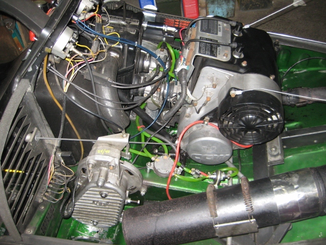

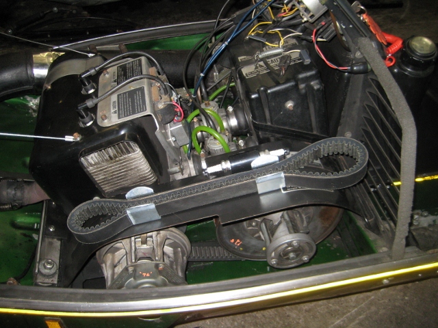

Here is a couple pictures of my latest completed project. It is a 1978 Cyclone 340 chassis with a 76 440 powerplant. The project started with a 76 cyclone that I bought a few years back. The chassis was pretty beat, but it had 1800 miles on it. I had a parts 76 LF 440 engine with carbs and decided to try to put the LF carb setup on the cyclone. I got the the changeover done and it ran well, but was plagued by issues of a beaten and neglected sled. This fall I found the 78 chassis that had a partial motor and no clutches. It was in very good shape and had been stored inside. I pulled the engine from my 76, rebuilt it, cleaned up the intake and ports, and then put it in the 78 chassis. I also switched the gears to the 1.68 ratio for more top end. So far, I have put about 35 miles on it this season and am happy so far. There are still a few tweaks to do with jetting, clutching, and maybe modifying the suspension for deep snow.

Very clean! Nice Job!

That looks real good. How much more travel does this give you?

The sled looks great! I had done a Trailfire suspension conversion on the sled that the motor came out of, and it worked well. I didn't do it to this sled, because I didn't want to put any new holes in the tunnel.
