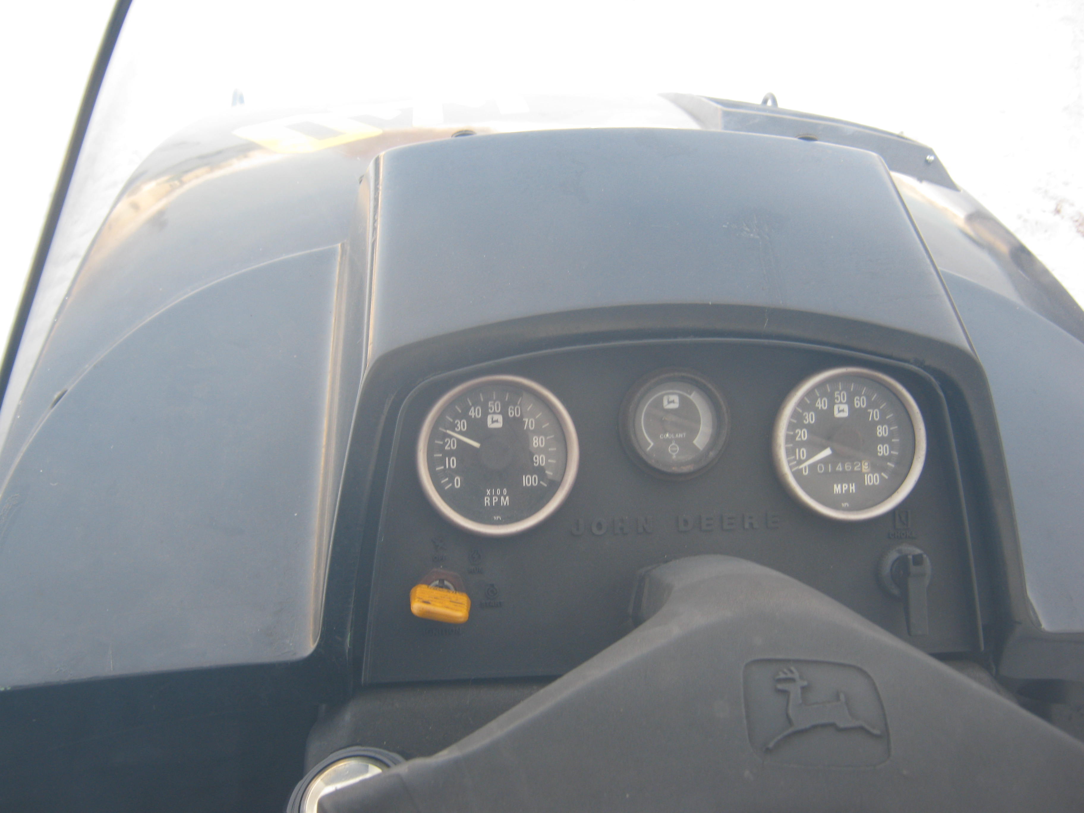

Post by air mechanic »
A shot of the dash of her idling.I found that my old used Cat belts off of 97 EXT600 TRIPLE fit rather well on this and clutching-trail performance seems real good!! :dance: Knew I kept those old belts for a reason!
