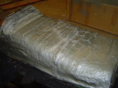

The seat on this sled is cracked down the middle ( full length ) with several across as well. Simply put, it is junk.
I had one other 00/JDX molded seat. Danzig had picked it up at Ed Meyer's place several years ago. It had been recovered with a fuzzy black fabric, but had a strange feel as to what was under it.
Katy and I were in the shed on Saturday, so we cut the cover off to see what we had. It was kind of like a Faberge' Egg, as we worked our way down through the layers. The black fabric was cut away to reveal the strange feeling surface below. The entire seat had been covered with...wait for it...Yes...duct tape!

I started pulling the duct tape off, pretty sure I wasn't going to find a pristine seat under it.
There are two cracks like that across the seat, and they are 3-4 inches deep. Not exactly a great foam to recover either. SO,...I am still looking for a recoverable 00/JDX seat foam. The wife's tender bottom may be sitting on this, so I would like a nice one.

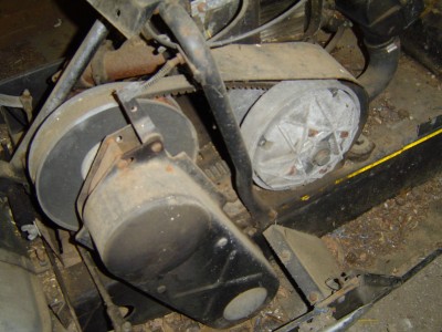

The 440/21 came out this weekend, and the Salsbury clutch has been successfully removed.
A quick compression test showed 140 on the pto side, and 125 on the mag side. A bit of oil down the weak side and it came right up to 140, so I'm pronouncing the engine good to go. Clean-up and re-seal will commence.

The sled is showing a little less than 1000 miles on the clock, and it has none of the updates, so you would kind of assume it would be relatively unmolested. It still had the original WDA-34 Walbro on it, but when I was getting ready to pull the engine I noticed something a little different. We've all seen some questionable repairs made to these old sleds, on this one it was on the carb. I had a screwdriver in my hand loosening up the choke and throttle cables, and so it was quicker to remove the two screws that hold the bracket that the cables mount to, than it was to find a wrench to take the cables off the bracket.
The two screws that hold the bracket on top of the carb have a JD part number, but are also listed as .168 x 5/16".
What I saw looked like a watch stem in the top mounting hole. It was a chrome knob...I took my pliers and got it loosened, then turned it out by hand. I turned and turned, I was a bit shocked to find that the screw was around an inch long! Apparently it didn't interfere with the choke or throttle butterflies, but all that screw was hanging in the throat of the carb, and that is an air restriction! :laugh:
