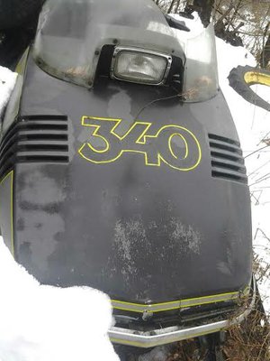

Hi Im the new owner of this liquifire i got it for $100 its free but doesn't run he said it ran when he parked it This is my first sled and i have many question like
In the service manual it says to us leaded gas what do you guy use as far as fuel?
How do i remove the seat?
Im going to get it this weekend so all have many more question then thanks

If you can find regular leaded gas, go for it. With today's gas, running unleaded is fine.
The seat slides intro clips behind the fuel tank and is bolted to the rear of the tunnel. Lift up the snow flap and look for the small bolts, one on each side, just inside the tunnel.
