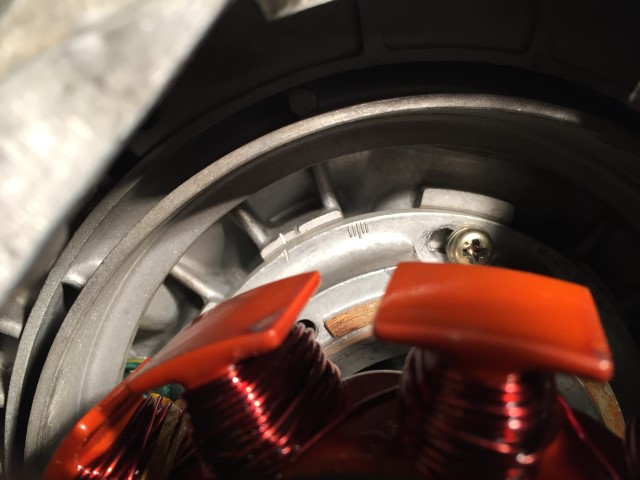

When I was replacing The stator today I noticed there was a little bit of play in the fan and it was kind of oily around there. The grease was coming out of the bearings and the outer part of the bearing is little loose in the housing.I replace the bearings last year with number 62042 RS C3...RBL made in China . I checked the original bearing that I took out last year and the number is 6204V made by NSK . Maybe the bearings that I put in last year are not high-speed ,high heat and that is maybe why the belt started to shred also??? If that's a possibility does anyone know if the original type bearings are available ? If not I will probably put the original bearings back in .
Any suggestions would be appreciated. Thanks Glen

Re: Barn find
I believe Rainville has NOS ones. I have been replacing mine with NOS I bought from DK years ago with no problems to date.
