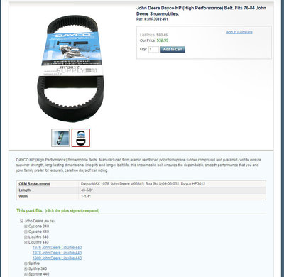

Yes I'm running the JD belt, but it still looks good. Are you sure the 1107 belt is the correct number? I come up with a different number, 1078, this belt is a 1/2" shorter than the 1107.
Thanks, Paul
Re: 80 Liquifire Clutch Questions.
1107 is the correct belt. 1078 fits Trailfires and Sportfires.

Are you guys sure about the belts? I looked at Dayco's website and another site I buy parts from and they both indicate the HP3012 belt (Dayco Max 1078). Theres a 1/2" in length difference.
