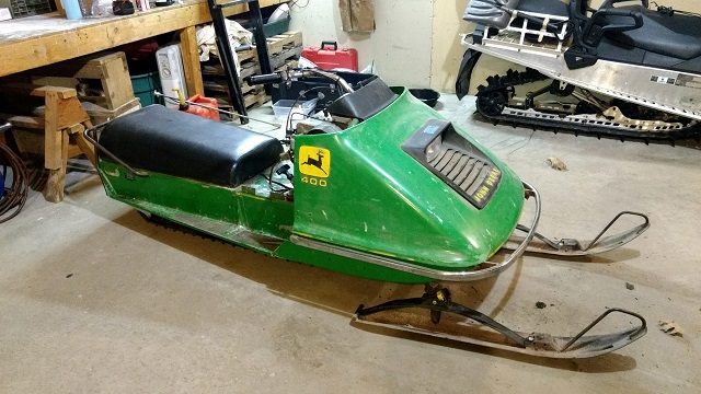

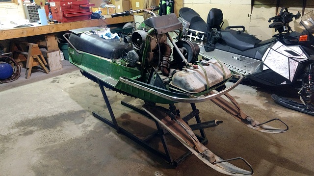

After the craziness of the I-500 was over, on Sunday morning 12th I pointed the dually south from Bemidji toward the Twin Cities. I was going to stop and visit Babbler in Becker, and pick up a load of Liquidator hoods on may way over to WI. Since the I-500 ended a day earlier than planned, I was hoping to use the extra time to get the 400 finished up.

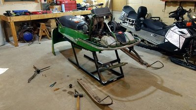

The sled was definitely in "Kit Form". While the motor was together and the drive train was assembled, there was much left to do including: install the fuel lines and tank, either rebuild the carb or steal one from Lindner, fix the brake, install the drive clutch and attempt to service both clutches, try to sort out the wiring and lack of grounding, replace the leaf springs, front spindles, bushings and fix the slop in the handle bars, replace the rusted headlight with an NOS one, install the hood, motor cover, seat and windshield and finally an NOS snowflap kit. Sure, no problem.
One nice thing about staying at the Whitetail is they are always very generous about letting us use the garage, and this year was no exception. I rolled the 400 in on Monday and got to work. First thing go to in was the fuel tank, then the drive clutch went on...

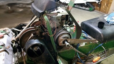

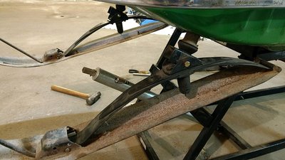

One of the next things to be taken care of was adjusting the brake. It was out of room on the cable adjuster, so I tried moving the brake band pins to the alternate location, but that overtightened it. So I had to move where the cable attached to the band actuator lever. Seemed to work well enough to move on to the steering.
Even though this sled only had about 1,400 miles on her, and the speedo still worked when I took the driveshaft out, you could move the ski tips in and out about 6 inches without disturbing the handlebars or tie rods. Most of the slop was traced down to the lower spindle bushings where the spring saddle attaches. Of course it was all rusted together. Plus, the bolts that held the spring pack to the saddle were also sloppy. Oddly enough, even the springs were sloppy in the ski's, adding to the play in the steering.
The "quick fix" was to replace all that with new parts. So in went NOS spring packs and spindles, and new bushings that are still available from Deere (borrowed from the X-8 resto). Additionally a set of Joe Wanie's reproduction ski spring sliders were used to tighten up the fit of the front of the spring into the ski. NOS ski pins where the final piece to lock it all down.
The difference was huge. The front end was much tighter with minimal play in the skis. I gave it an eyeball alignment to make sure the ski's were toe out a bit and called it "good enough". Onto the next problem...

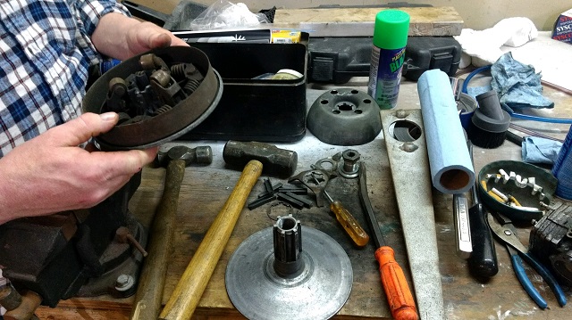

By now it's Thursday night, the evening before the Bogie Bash is scheduled to take place. I have already driven back and forth to retrieve Cari and RJ from the MSP airport and attended the HoF board meeting. Lindner arrived in St. Germain Thursday evening and met me in the garage to do his favorite thing on vacation: work on my junk sleds!
True to his word, he brought along a rebuilt loaner carb that functioned like new. We bolted her up, ran the new fuel line and the in-tank pick up, and she purred like a kitten. Maybe sure purred a little too well...as the darn Salsbury drive clutch locked shut! This could have been one screw up that killed the whole deal. But, we pulled it off and found the manual was almost no help in taking the clutch apart. So we did it the hard way.
Once the cover was off we found all three rollers were locked over-center on the roller plate that was probably supposed to prevent that. While trying to undo that mess, we accidentally sent that triangular piece flying up into the wall, just missing Brian's head and the window in the garage. Lucky on both counts. After that we found the clutch to be in fair shape, gave it a quick clean up and put it back together. We then installed one of the new drive belts Matt had drop shipped me to prevent that from happening again...

Time for a belt and a test run, when we notice the clutch is fully closed...
I have no issues with the little Salsbury clutch, Deere used it on the 300 throughout its run. Joe's 400 is showing 1400 miles, and I did not see any significant wear. The rollers are rusted from sitting, that is about it. But here is the deal; on Comet clutches, a couple tools make working on them much easier. On the Salsbury, there is at least one tool you need to avoid personal injury! It is very simple, it is a medium size flat blade screwdriver, with the tip bent slightly, and a hole drilled in it. You put the tag end of the roller arm spring through the hole, then you pry the spring off, taking the tension off the arm. These springs are like the spring of a mouse trap, and the stored energy is likewise looking to bite you!

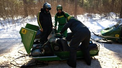

Friday Morning (February 17th, 2017) the small, dedicated, (maybe a bit crazy) crew began to gather out in front of the Whitetail. I fired up the 400 and drove her out of the garage and took her for a short test ride down the trail, passing Lindner coming the other way on Katie's 400. Must have been some magic 400 mojo in the air, as Brian witnessed a small miracle happen right in front of him: My headlight came on! And from that moment on the entire electrical system 'healed' and worked fine all weekend. The headlight, taillight, kill switch and key switch now all functioned normally and still do.
While a good sprite found my sled, one left Brian's 400 and it had to be left behind. While we gathered at Dave's trailer, I only saw Brian there, not Katie. He said her sled was having one of its infamous temperamental fits and she was not joining us. I look over and see Mrs. Lindner, all dressed to ride, walking toward the hotel from Brian's trailer. "To hell with that!" I say. I asked Brian if she would like to ride Cari's Sprintfire. So I ran over, grabbed the sled, and rode it over and offered it to Katie. She was a bit reluctant since I needed it the next day, but I would have none of that. She got "upgraded" to an oil injected, slide rail, liquid cooled dream machine, LOL!
Once we were all done fiddling with our sleds, the 6 of us took off toward Sayner. Captain Clark and his nephew Andrew on a Cyclone and an 800 respectively, the Lindners on a JDX-8 and a Sprintfire, Jason on his better than new 800 and me on the recently re-assembled 400. For the first time, not only was the "Bogie Bash" half bogie sleds, but once again we were all JD's.
"What could possibly go wrong?" Well...almost everything...

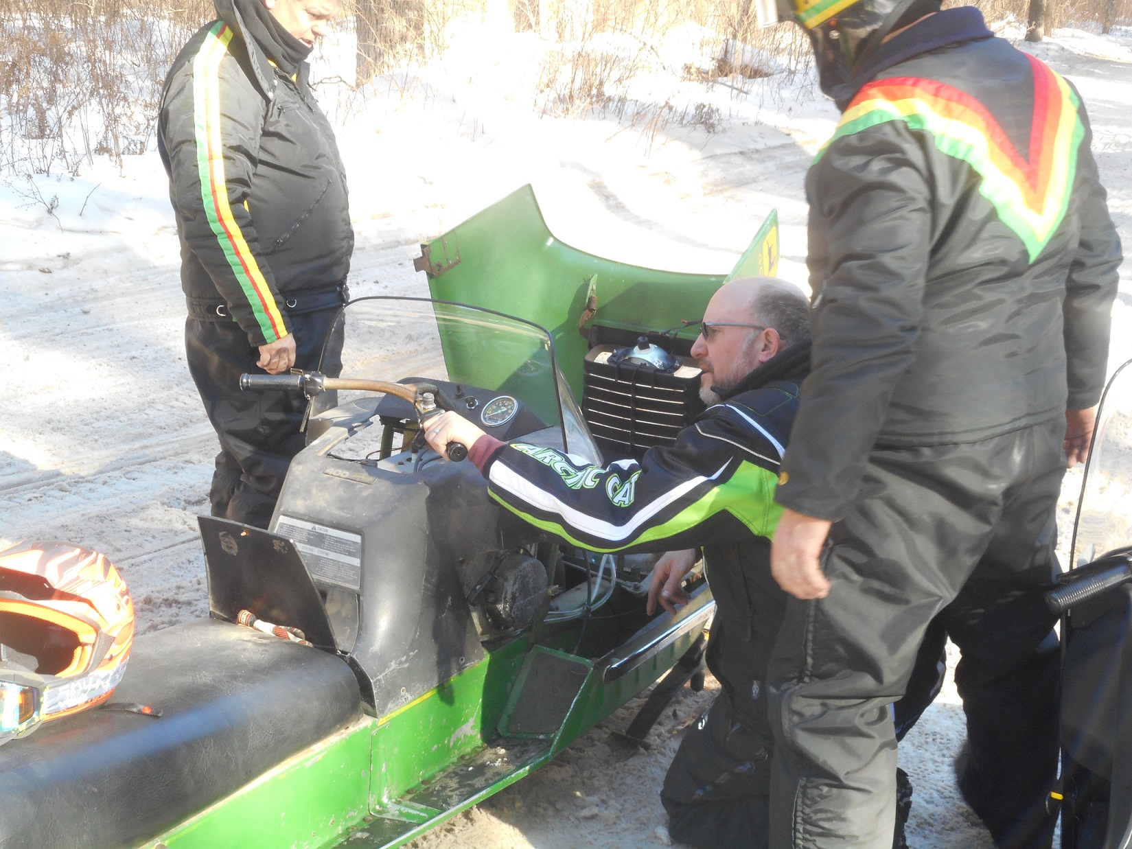

I never knew how long the 15 minute ride to Sayner could take. Turns out an hour or so is not out of the question. Andrew's 800 was acting up. Who needs the high tension side of the CDI anyway? Then my 400 was dying out, but would run with about 3/4 choke. However, Brian's carb had the choke cable hook up on the opposite side of the carb from mine, so I had to ride it with my hand down in the motor cover, manually modulating the choke lever. Not fun.
So we finally checked it out just outside Sayner and found that we had the fuel and return lines hooked up backwards at the tank so it was pulling air, and on further inspection, the impulse line was split lengthwise. After the well prepared Jason saved my tail from his magic back pack, the 400 was stuborn to re-fire, but once started, she ran, and started easily the rest of the day.
And we were off...but burned a lot of time just to make it to Sayner. But we did make it to the Mobile station to regroup...

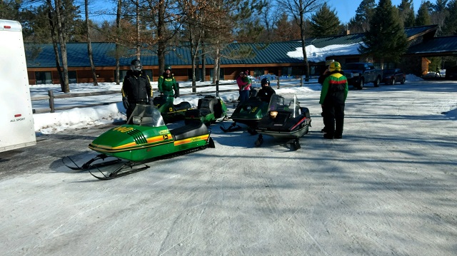

We had originally planned to be "Katie's Bogie Bash to Bolder" and have lunch at Bolder Junction. But with all the goofing around, we almost became the BB to Sayner! In recognition of the time burn, and still wanting to get back to the HoF for the cookout, Brian suggested we jump across the lakes and hit Stillwaters. We have driven by the place a million times, but like Brian said, never stopped in. So we pulled in, snapped a few photo's, definitely got the attention of a few of the locals with our old iron, and sat down for nice meal.
The return ride was almost uneventful...until Dave's Cyclone ran out of fuel on Star Lake. The carb on his 78 Cyclone was out of adjustment and it could drink some serious gas. We got it taken care of, and we all headed back to St. Germain and made a "Triumphant" entrance into the HoF parking lot in plenty of time to enjoy the cookout
In summary, it was a thrash to get the sled ready, but worth every hour to get to spend the afternoon with such a great group of guys. If there was an award for "Bogieing with Distinction" it would go to Jason Peterson and his beautiful 800. I am already on Lindner's case to completely rebuild Katie's 400 motor from the crank up, and my 400 will get the clutches properly serviced, along with some paint on the black steel parts in preparation for next year. Oh, and I should rebuild my own carb so I can return Brian's loaner.
Thanks for the all help Lindner and for a great day of riding guys. See you next year...for the "Bogie Bash to...where ever we make it to..."
