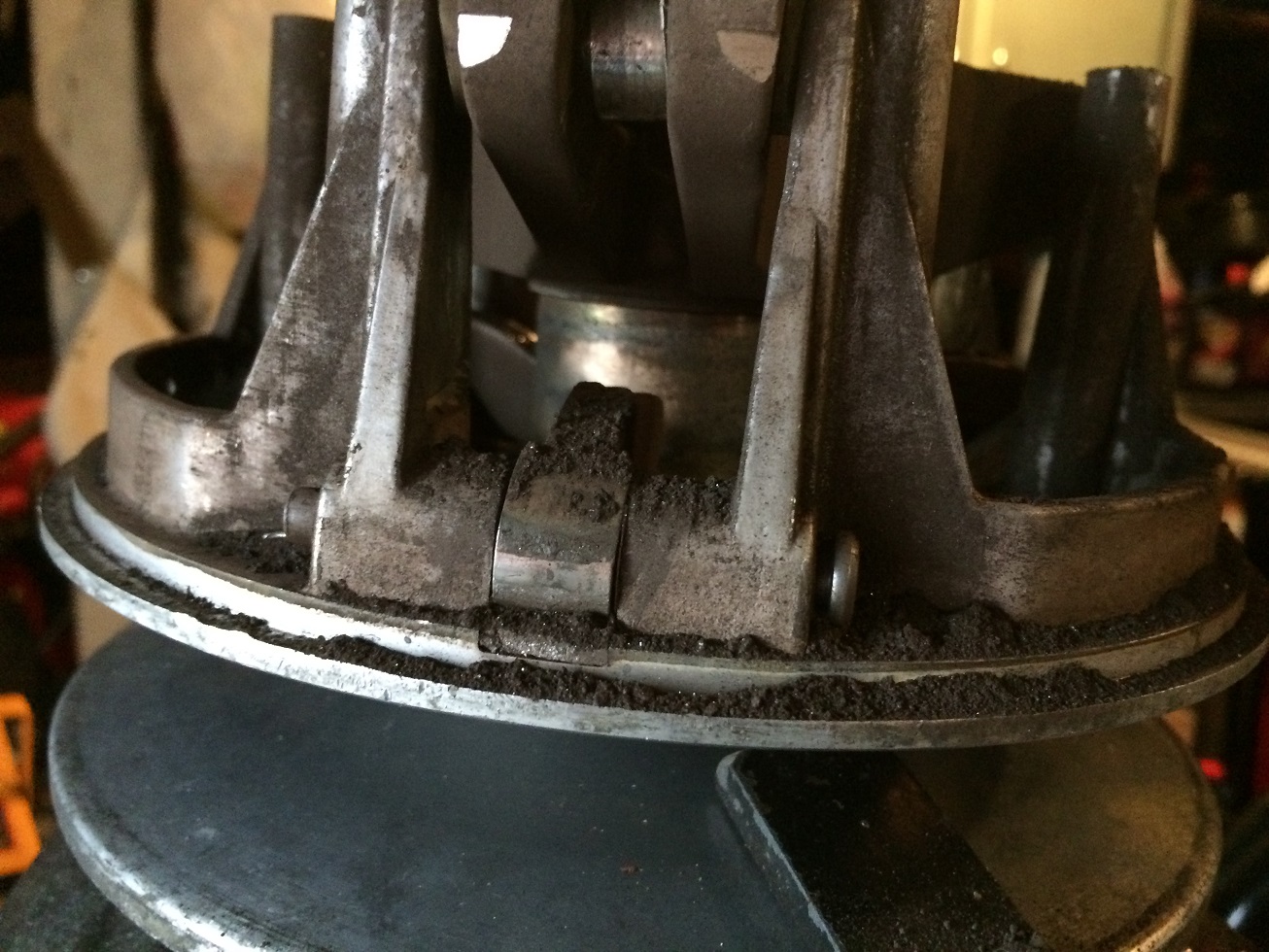

Part 2: I got the 101c off my 800 and opened up the can yesterday on the bench. Wow what a filthy mess. It has been said that this is a major reason the cans are no longer used. I cannot believe the amount of fine powder dirt/grime/carbon, whatever you want to call it.

Now here is the interesting part. Take a close look at the rollers and fly weights. I was amazed at how flat spotted they were, and how the weights were completely grooved on one side and worn flat on the curved portion of the weight. The pivot pin was worn thin as well. I cannot believe I could even drive this sled with the condition of this clutch. It wore this way on all three weights. I guess this happens, but I was simply blown away that it could still work like this.
