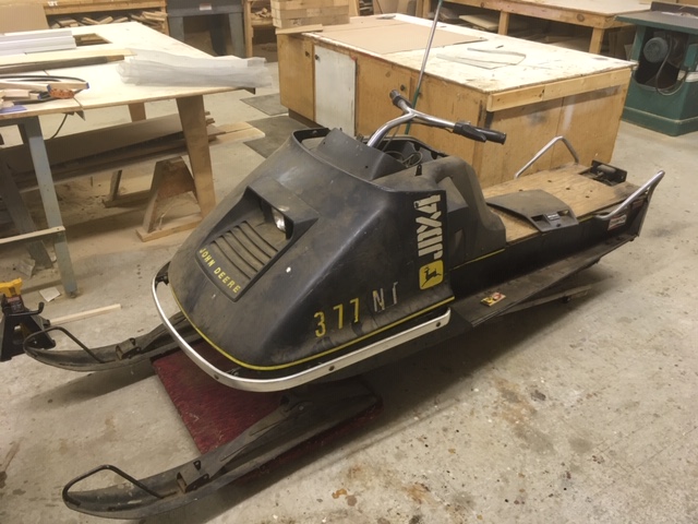

I have a 73 JDX4 with a K2952AX. I am just starting the process to make this a rider machine.
Some questions I have so far are: can I find some new rubber motor mounts? Can I find a fuel check valve that goes in the fuel tank? Matt has sent me the link for the engine seals.
I did a compression check and both cylinders are 120+. I am ok with that.
I have some photos of the machine.
Obviously I need a seat, and not sure how the fuel tank is going to clean out. Hopefully this will be a worthwhile project.

Not bad at all. Looks pretty straight up and you even have the engine cover.

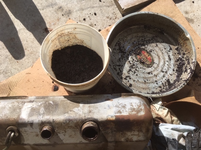

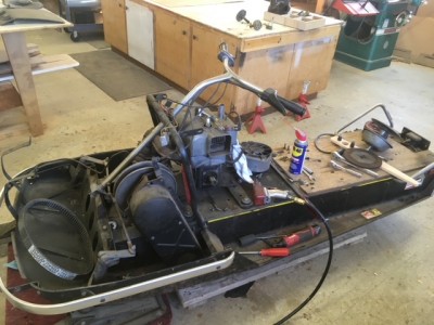

I tore it down a little tonight and some of the things I will need to find are some rubber motor mounts and clutch removal tool. I'm also in the process of cleaning the rust out of the fuel tank. Is there a good aftermarket vintage snowmobile parts magazine/website????

Working on it today. Trying to pull the clutch off. I want to put new seals on the crankshaft without tearing it down. Anyone know where I can find a jdm-28 clutch puller or another one from a different machine that will work?
Re: 73 JDX4 project
I think Newbreed Parts has them.?
