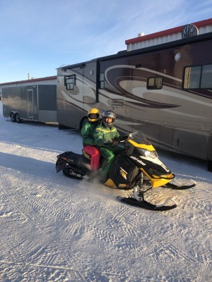

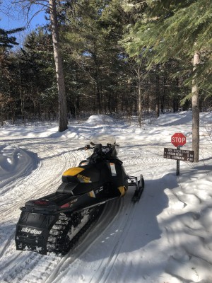

Feb 18/20 tue feeling brave again I went on another Lone Ranger ride believe it or not on a skidoo,I have never ever in my life put that many miles on a yellow one in all the years and miles of riding snowmobiles.It was Maynard’s which we took for a spare in case one of the five John Deeres broke down but none ever did. So Maynard suggested that I take it for a ride and it was a pleasure to take him up on the offer to ride the newest most powerful snowmobile I’ve ever driven. :sled:
This time headed west around Woodruff and towards Arbor Vitae then back to St. Germain (42mi). Got better at reading the map and knowing the intersection numbers helped to know that you were turning at the right corner.
Even got Edna to ride with me a couple times on the Ski Doo And she said because you’re sitting up higher it was more comfortable than 340/s (That Hurt) :(
