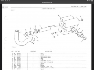

I was looking at the parts catalog to find the part number for the boot between the airbox and the carburetor on an ‘80 Trailfire 440 and noted there is a restrictor (item 3 on the illustration) installed in the airbox inlet. I have owned 2 440’s and 2 340’s and don’t recall any of them having a restrictor installed. Now it could be that they were removed at some point because all of my sleds have led hard, neglected lives….. Anyhow all I can figure is that the restrictor could possibly be installed to keep it a bit rich at high power. Any thoughts? Should I be concerned about it not being installed?
Also, any workaround for the carb / airbox boot?

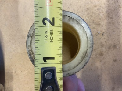

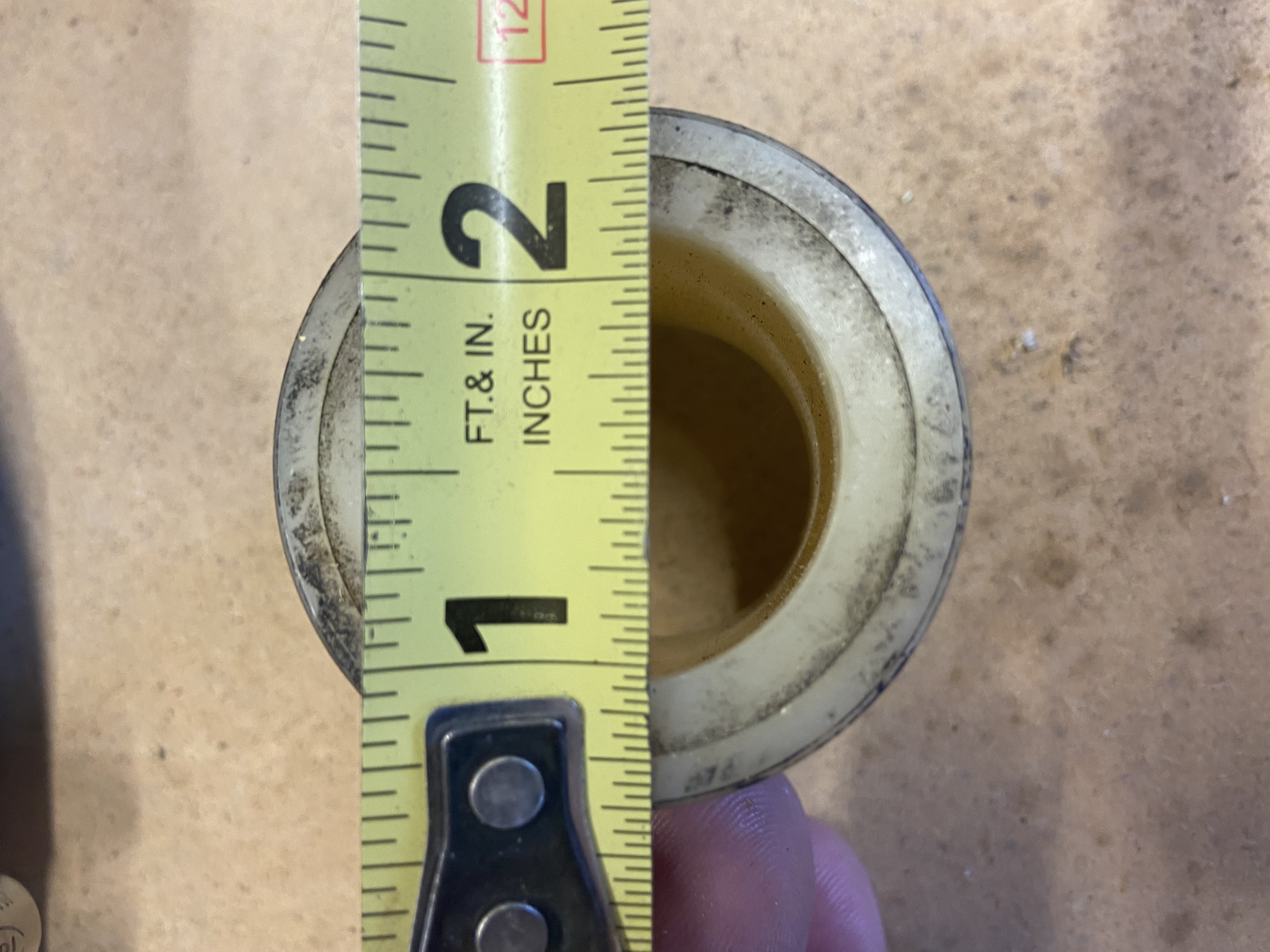

It looks to me like it’s basically a reducer tapered down from approx. 2” down to 1.25” I.D.
Here’s a few photos:

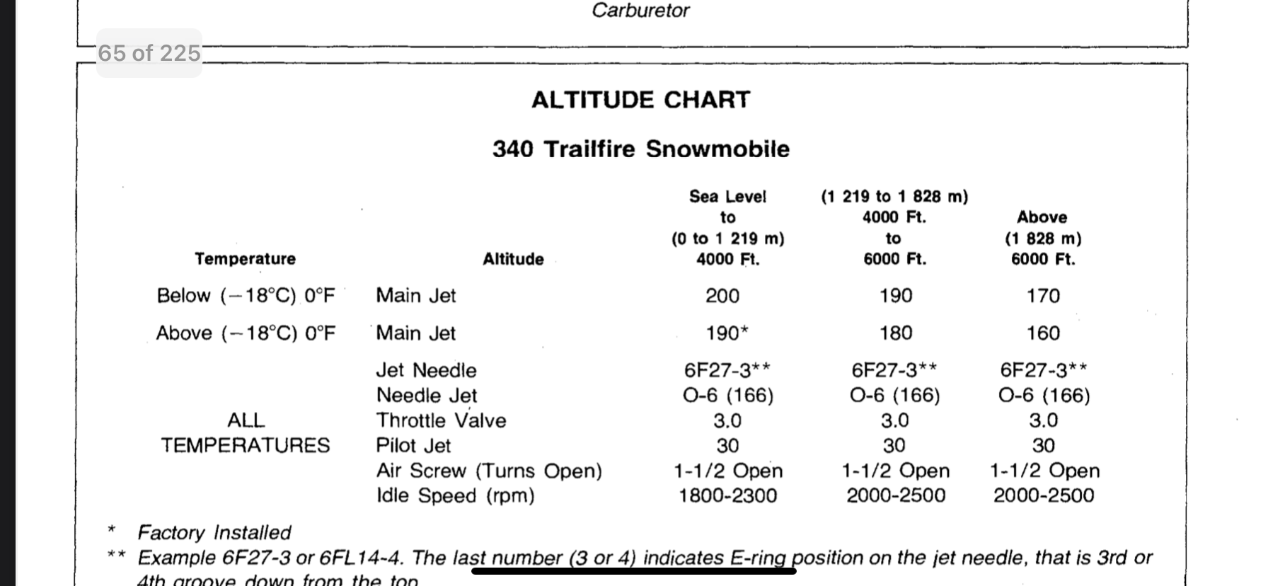

I could be way off-track here, but I presume the restrictor is designed to “meter” the air intake to sustain an ideal air to fuel combustion ratio. If removed, this could be compensated via the Carburetor Air Mixture setting, but I’m sure there is a very good reason it was included in the design by the original engineers.

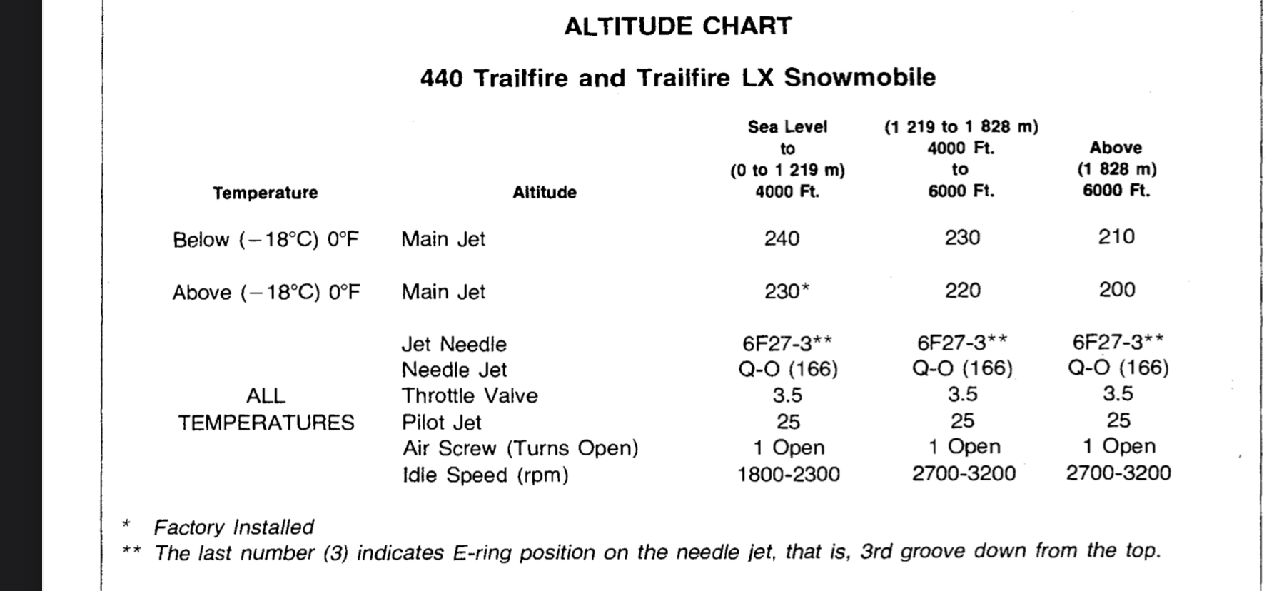

As there was a different restrictor for the 440’s, it would make sense that the taper would not be as aggressive (perhaps down to 1.75”?) to supply a larger engine, so it may not be such a big deal if it is removed.
However, I suspect it would be much more noticeable for the 340’s if the air intake was 2” throughout. Again, this could be compensated via the Carburetor Air Mixture setting, but would not align with the original recommended setting of 1.5 turns out.
Thoughts?
