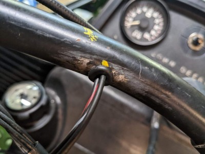

So I have been talking about this for a while, it was time to get it done.
I slid the grips off the bars, and took stock of the situation. There was a substantial ridge inside the bar that needed to be removed before anything else could move forward. A round file cleaned that up, so I could now test the fit of the heating element.
This one is different from one I had installed many years ago. The early kit supplied lead foil to wrap around the element to make it fit tight inside the tube. This element has a tang spot welded on, which you can bend an arch in to make it fit tight.
I didn't need an arch in this case, I needed to file the tang down to allow the element into the tube. So I filed and sanded the inside of the tube, and filed the tang and polished the element until it would slide into the tube.
Next I drilled a hole in the tube between where the grip mounts and where the bar is welded to the steering shaft. I de-burred the hole so the grommet would fit well. Then I went fishing...a wire was ran thru the hole out to the end of the bar, the electrical wires attached, and pulled most of the way through.
A piece of the supplied fiberglass insulation is poked into the tube ahead of the element, a bit of soap was smeared on the element, then the assembly is pushed into the tube until it is a bit past flush. Insulation can then be added to the outside end. A grommet is slid over the three wires, a bit of soap added, and then the fun begins of getting the grommet into the hole. Once that was done the wires were taped to the bar up out of the way.
Then I got to move to the opposite side, and do it all over again. The switch has been installed in the dash, so all that is left is to get it all wired up.
