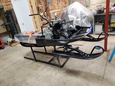

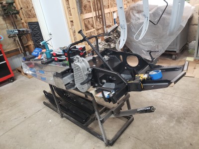

Last fall we started reassembly. Things started to come together rather quickly but then I allowed the TPR panels to sideline the project for several months.
Both panels had issues. The bottom of the right panel was torn at the chain case bump and the left panel had a small tear that was repaired with an aluminum plate and several rives. This was one of those deals where the repair caused more damage than the original issue. I did a bunch of research on plastic repair but eventually purchased a pair of better TPR panels. Several months were lost to my stagnation.
It was about this time it occurred to me that spring was quickly approaching. The significance here was that Larry was graduating high school. I knew that I need to put as much of the sled back together before the commander took it upon herself to "clean" out the shop for the big graduation party. I would have liked to have been a little further along but at least we had a rolling chassis before the commander stepped in and scattered parts all over the loft area of the shop. I have yet to recover from this and have a few other projects that are going to take precedence. This is a photo of where the project is today.

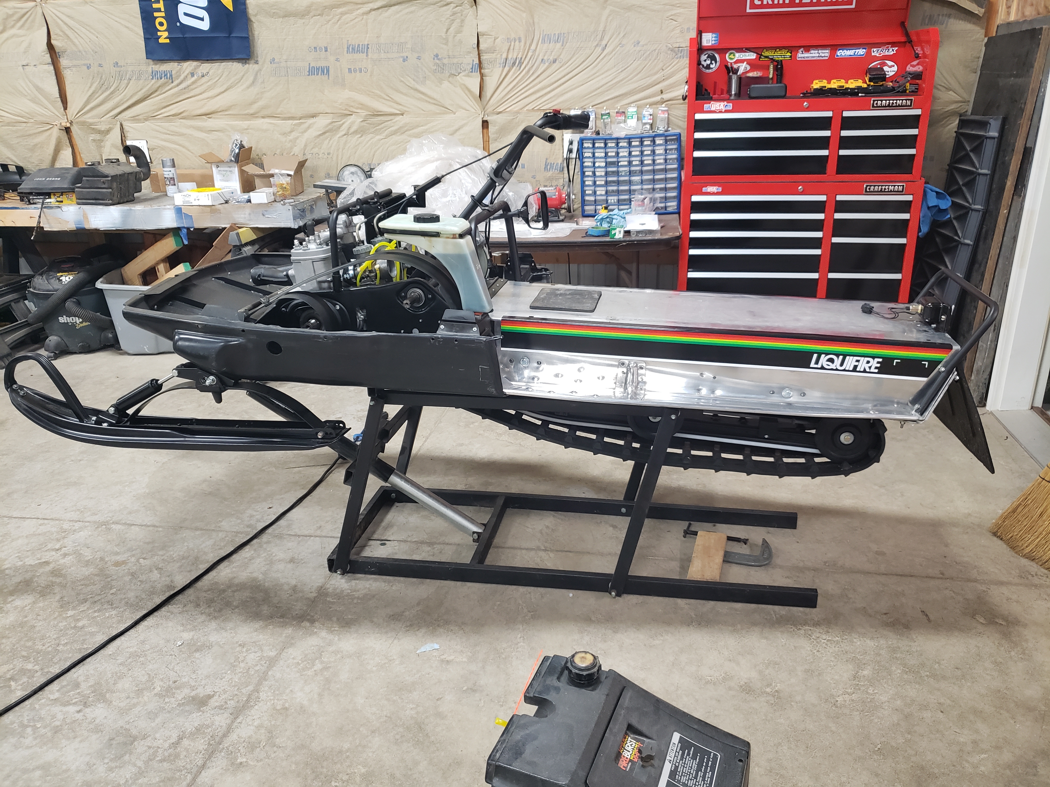

Been slowly plugging away at this thing when I can find time and thought I would toss out another photo. My initial thought was that I haven't done a lot but putting it in writing there were a lot of little items. Tunnel decals installed. Hitch, snow flap, bumper installed. Recoil restored and installed. Throttle block and all switches on the block cleaned / repaired. Carb flanges / carbs installed. Oil tank installed / plumbed and initially bled. Throttle cable adjusted.

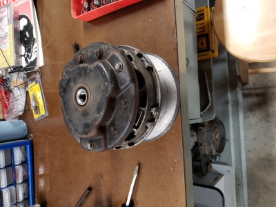

In typical fashion one week turned into a month. Anyway the motor is back in the sled. Took a little time this weekend and cracked open the TR-800. This is new territory for me. First one of these I have been into. Still trying to assess the situation and comeup with a plan. The arms and rollers were tied up (mostly due to the thrust washers). Polished most of the parts and those are freed up now. The thrust washers are toast but the rest looks like it still has life. Don't have photos to share at this time.

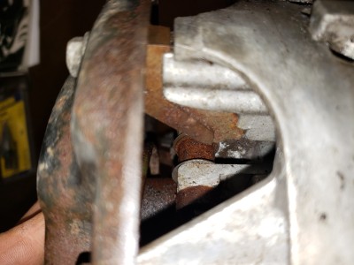

Thought I would toss out a few photos. Progress is slow with this TR800 but it is still moving forward slowly. There was a fair amount of rust / corrosion on this clutch. The thrust washers are toast and the pivot pins should be replaced. The rest of the parts and bushings have cleaned up well.
Spent quite some time vasolating about the thrust washers. Over the years working on the 102Cs I have noticed that back in the day the thrust washers were metal with some sort of slippery plastic (I'm assuming these may have been Duralon thrust washers?). Most of these seem to de-laminate as time passes. If you purchase a Comet repair kit today these thrust washers are plastic. I found reference to them being made of Vespel. I priced a piece of 3/4" x 12" Vespel round but really don't want to go into debt for a few thrust washer.....wow.....they are very proud of the stuff. Next up I made a few washers out of a sheet of Turcite as a test. The stuff I had was intended to be glued to machine ways so I had 2 washers with the slippery sides out. In the end I didn't like the stack thickness (probably could have scraped them to the proper thickness but I wasn't keen on the idea of these from the start). Finally I made them out of Delrin. We will see how this works out.
Last week I spent some time re-plating some of the parts and fasteners but once again my indecisiveness is holding back progress. I've switch back and forth a few times about replacing the dowel pins (because of rust pits). I've finally decided they will be replaced but I'd like to check the hardness of the original pins before ordering new pins (hoping I accomplish this tomorrow).
Anyway, tonight I took a few minutes and assembled the rollers on the arms. At least these are ready to go.
