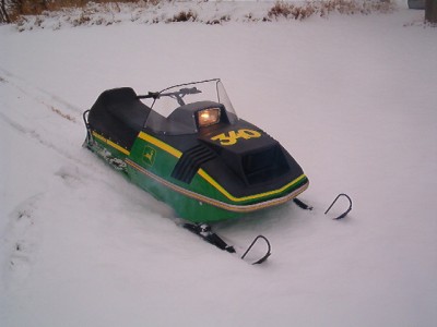

Here is my custom JD it has an AC track with a LF suspension. So far it seems to work well but 20 miles isn't enough to say for sure.
