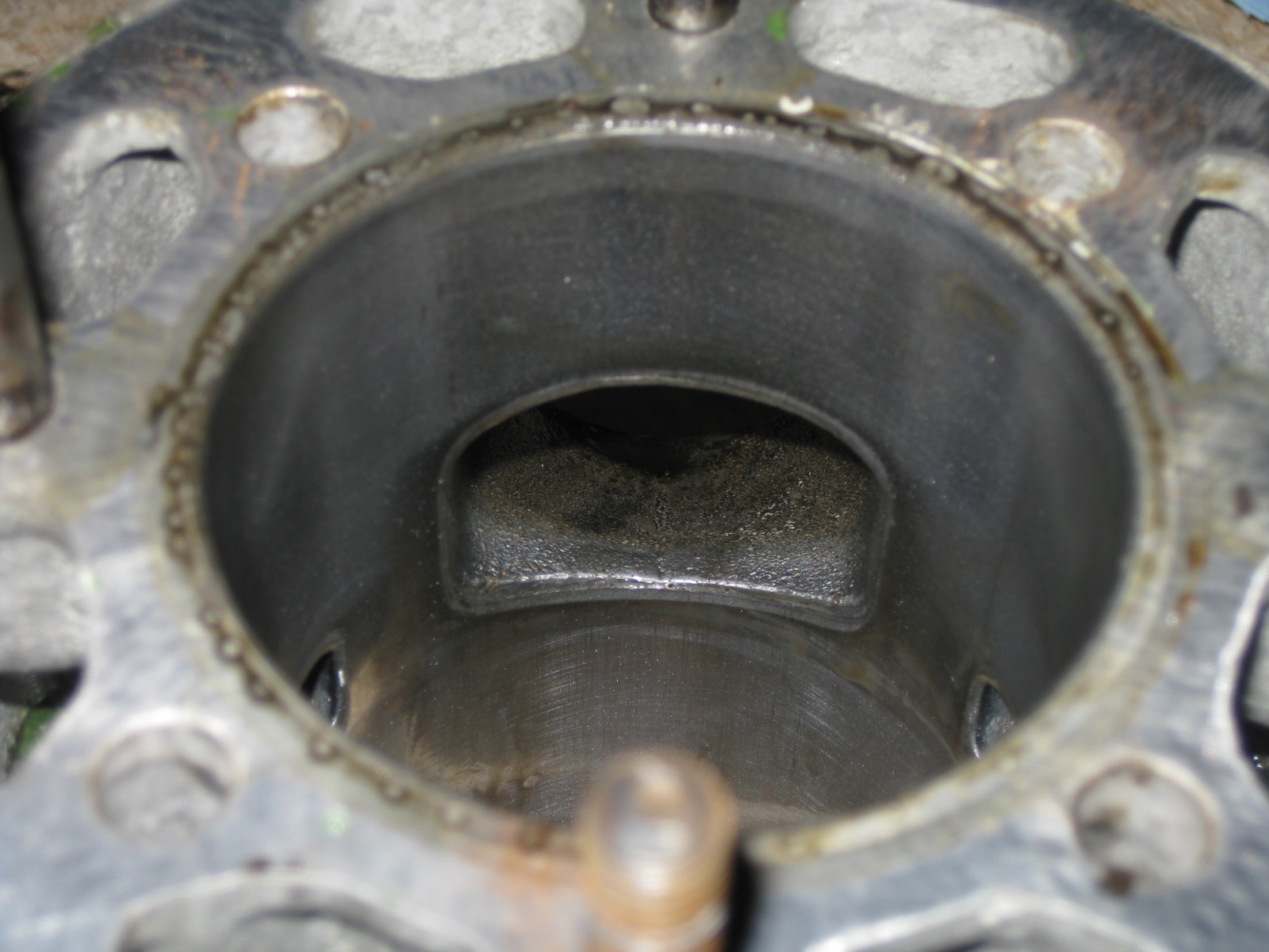

1980 Liquifire 440. Late last year took out a piston on the Mag side, didn't damage the cylinder though. Engine had about 100+ miles on it. Did some measuring on the cylinders and the Mag cylinder on the side to side(45 deg. from intake/exhaust ports) is right at the wear tolerance, actually about .0001 over wear tolerance. I got 2.6782, manual states wear limit at 2.6811. I guess this is why if failed. The PTO is still in spec. The rings looked like it caught the exhaust port on the power stroke on the way down, as the rings are bent up. These are chrome cylinders, bought NOS unused on ebay. Crank has been rebuilt, bearing on PTO side was damaged and replaced. Have new pistons and full gasket kit. Have a 80 parts sled, engine not seized, hopefully jugs are in good shape. Another winter of repairs.

That is not why it failed. Don't know exactly why, but that is not it.

Who measured the bore? Takes very good equipment to measure to four places.

I measured the bore with a tri-post bore mike, accurate to .0002. I build turbos at my job, so I know how to use them. Because the bore mike measures at 3 points, I turned it to measure at 6 points in the bore, at the top(below the ridge), middle and at the ports. The cylinder has no score marks on it, just worn a bit on the mag side.

Here is the cylinder.

Cylinder looks good. You have the right stuff.
