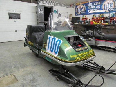

NICE 295/s you have there! Looks a lot like a 74 factory I-500 sled for some reason
Watch out for that Sprintfire in the background. After all those years on 4" of travel or less, that 7.2" of movement seems pretty plush.

I picked up Jim Dano's sled from Jim Tradup last summer. I took Jim's hood off, and did up another hood like you see in the picture. I feel fortunate to have a sled that was on our team in 74.
Hey Jim D, if you read this, and want to go for a ride on your sled sometime, let me know, the sled runs great.
Joe i picked up the Sprintfire from a farmer friend this winter, and yea it sure has a softer ride than the 295/S,but the 295/S looks a lot nicer. I'm just getting the hood re finished on it, then I'll post a few pics of it.
