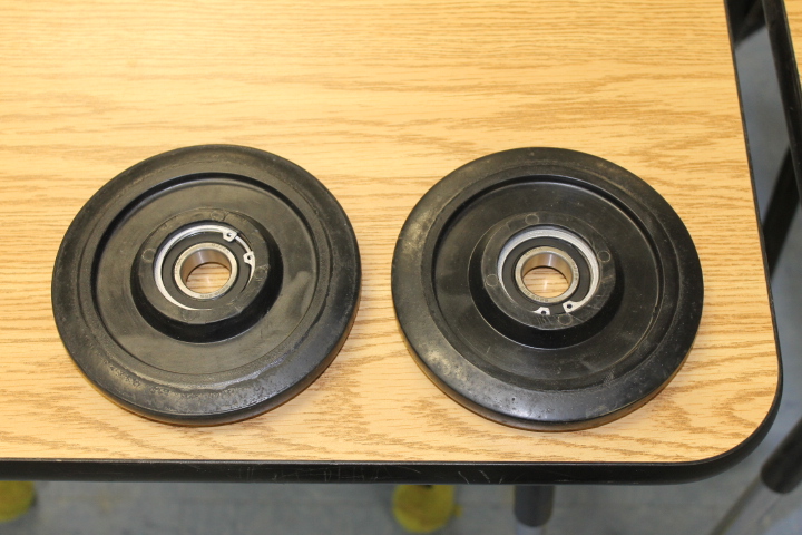

More Work
Idler wheels cleaned up with new bearings, ill post the part number later. I gotta find the boxes

Re: 1984 Trailfire LX Resto
Idler wheel bearing part number parts master brand PM205FF 6205-2RSJ
