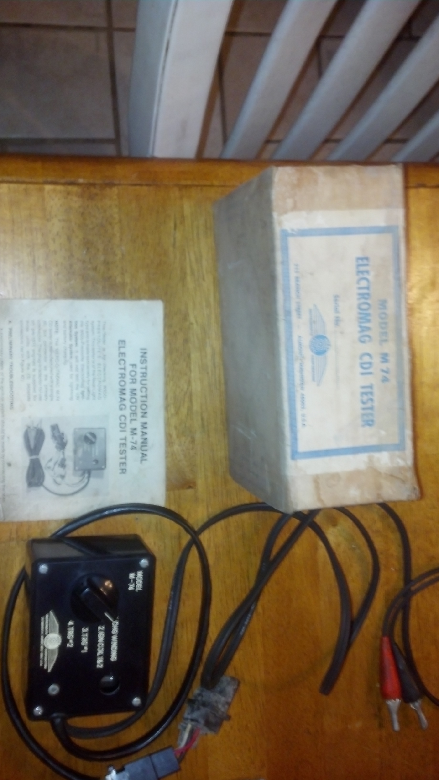

This was in my garage in a box of NOS ditch pickle parts.. I guess I need to be more observant !
Jdrob

Now I'm confused. Rob, why does your tester look different than the yamaha one that's on eBay? The picture in my liquifire manual looks like the Yamaha tester and is called m-74 tester, but so is yours?
Also, what is the simulator (that Greg likes so much) used for.....test the functionality of the tester? The liquifire service manual shows it but never describes what to do with it. Does it have a use on some other model?

Rob - I'm a tad confused as you have pictures of a Merc-O-Tronic CD tester. We had one in the shop where i worked as a Mercury Marine mechanic....

Greg a "ditch pickle" is a Skiroule sled. I not supposed to mention other brands of sleds on here other than JDOk, and just WHAT is a "Ditch Pickle".....
Now as far as the tester goes, I am not sure if it will work for what I need it to do, but I shipped it to Todd (JDT) to see if he can make heads or tails of it.
I am clueless when it comes to electrical stuff.
