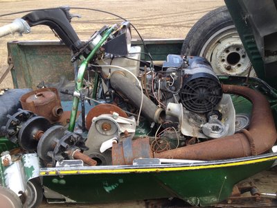

You got it Chuck she has been right with me all the time, (sometimes reluctantly)just past 48 yr. apr 30 Looking for ideas on how to remove seized piston and wrist pins????

Glen, if you found a Gal that is willing to wrench on sleds that's great. Never met her but like her already, next thing you will tell us is that she likes to drink beer to................. About that stuck piston, got to let it soak in your favorite solution that you get from an auto parts dealer. If that don't work I recommend explosives. <just kidding>. Is the crank any good or is that shot?

Got the other Cyl off, but the wristpins are seizes. Any suggestions to get them out without wreaking the piston or connecting rod.

340sracer wrote:Got the other Cyl off, but the wristpins are seizes. Any suggestions to get them out without wreaking the piston or connecting rod.
What are you using to try to remove the pins?
A couple pieces of tubing, some threaded rod, and as perhaps a bit of heat should get them out.

Got wrist pins out, sent picture of crankcase to Jerome and he said I need to find another crank because can;t get rods or rod bearings.
How do you get fly wheel off?

Remove the nut from the crank (impact works best), then use a harmonic dampener puller to pull off the flywheel. These can be stubborn, but a couple of hits with a dead blow hammer on the end of the puller usually pops them off.

As soon as you posted the picture of the pistons you could se that the interior of the case and crank were pretty green and crusty. Nothing that cant be worked thru.

If you can't find a good 340/RS-2 crank, there was some discussion a while back about guys being able to use a 340/5 or 440/5 crankshaft as a replacement in the RS-2 engine. I think the only difference is the RS-2 has the heavier rod with the "K" stamped in it. I'm sure Jerome can fill you in on the details of possibilities being the Crank King!
