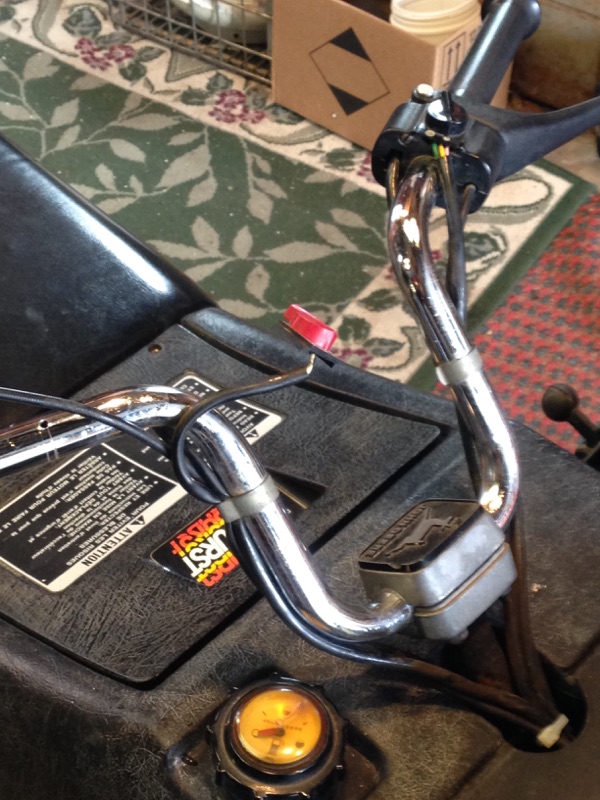

- Packers29
- Posts: 219
- Real Name: Andrew Engels
Re: 1980 Liquifire Project
Some more progress, I tried the aluminum foil trick on the handlebars and it worked great I also, Put the carbs back together and installed them along with some new fuel line. I also got some plastic cleaner and cleaned the gas tank and what an amazing difference. Don't mind the green electrical tape haha.

What's the aluminum foil trick you speak of? Your tank looks awesome as well, what did you use. I usually use hot water to clean, then I use stuff called frog juice, from a bike shop. It works well, but it only lasts a couple months. Later lincoln

You dip aluminum foil in the water and you rub the chrome and it takes off the rust flakes. it only works with light surface rust. Also on the tank and dash I used plastic restore by turtle wax is it the same stuff for restoring black plastic on cars.
