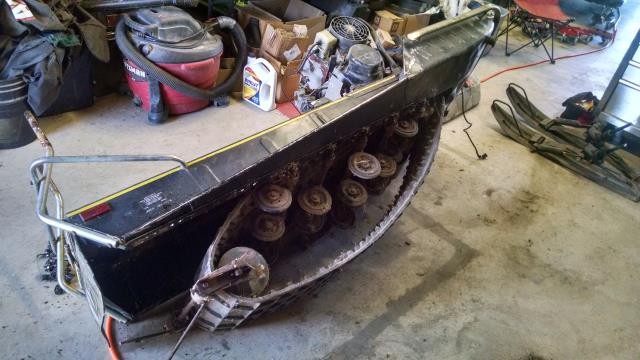

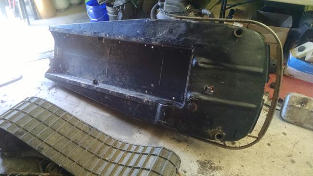

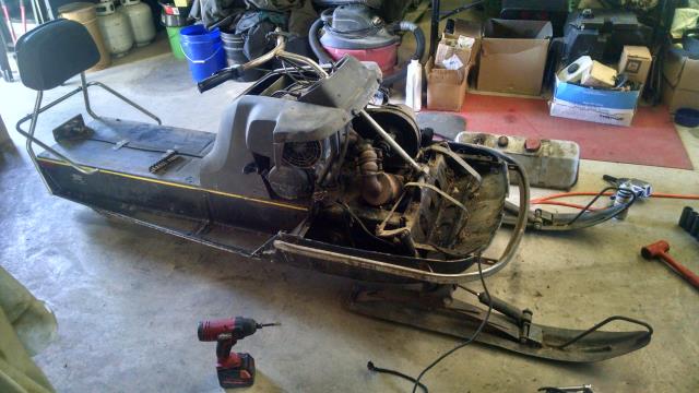

So this past weekend, the JDX-8 was stripped down to the bone. I started with removing the hood and body work to get a look at how to best get it apart. Last time I stripped a 73 JDX-8 down I was in high school...in the 80's...

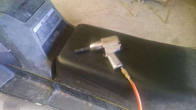

Taking a pic of a tool sitting on the sled doesn't count as wrenching on it!
Lindner: I had not yet begun to impact!
But, did that gun make short work of the 24 zillion carriage head bolts that hold on the bogie cross shaft mounting clips. I hit them all with "PB Blaster" first, and got lucky as only two of the bolts spun in their pockets. The rear axle was easy to remove from the chassis, but they tend to be a pain to actually take apart and service.
The worst of it was definitely the chaincase. Removal of the upper gear is not a big deal, but getting the lower gear off the shaft and removing the chain tensioners is kind of a pain. Apparently it also required a donation of epidermis and hemoglobin to expedite the removal of the chain and gear set. Needless to say I cut the back side of my hand and fingers on the sharp as hell lower access hole. Lindner added words of wisdom like "it is what it is" to my profanity laced text messages.
Once the darn lower gear was removed, the drive axle is actually pretty easy to get out, as the bolts thread directly into the chaincase assembly without separate nuts. For some reason the Goodyear "Pathfinder" track ended up on this JDX-8 instead of the original or updated Gates unit. It will be replaced with an NOS Gates track, and most of the running gear will be replaced with NOS parts. I plan to update the drive axle from the original 1" shaft to the stronger 1 1/8" shaft.
