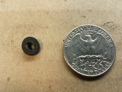

I also found a small thick rubber washer (almost like an o-ring) in the engine compartment today. I tried to upload a photo, but the file size is too large. Anyone know how I can change the file size to upload a photo?
Anyway, I'm curious if that little washer didn't come out of the carb somewhere...

Picture of the rubber washer I found in the engine compartment.
