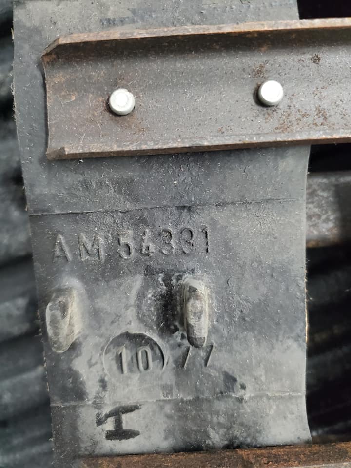

Can someone help describe the difference between AM54969 and AM54331? I think there is a difference in width, but not sure of other differences. Need this info. for prototyping. Thanks!

I can't comment on dimensional differences (if any) but I know for sure that they changed the mold design. The older track (AM54331) looks more like the older 70's cleated tracks with the "square knobs" between the cleats, but otherwise smooth. The new AM54969 has arrows molded in, as you know. The newer track is definitely a superior design.

Gary, I just remembered that a while back Joe Rainville made a post about the track differences through the years:
viewtopic.php?f=4&t=93&p=9694&hilit=track#p9694
I think the two part numbers you posted are the same dimensions, but there was a track style or manufacturer change. I think I just saw a NOS version of the AM54331 with the older design on Facebook, which confused me because the part number came up for Spitfire, but I thought Spitfire tracks had the "Chevron" Vs, but this one didn't. Now it makes sense.

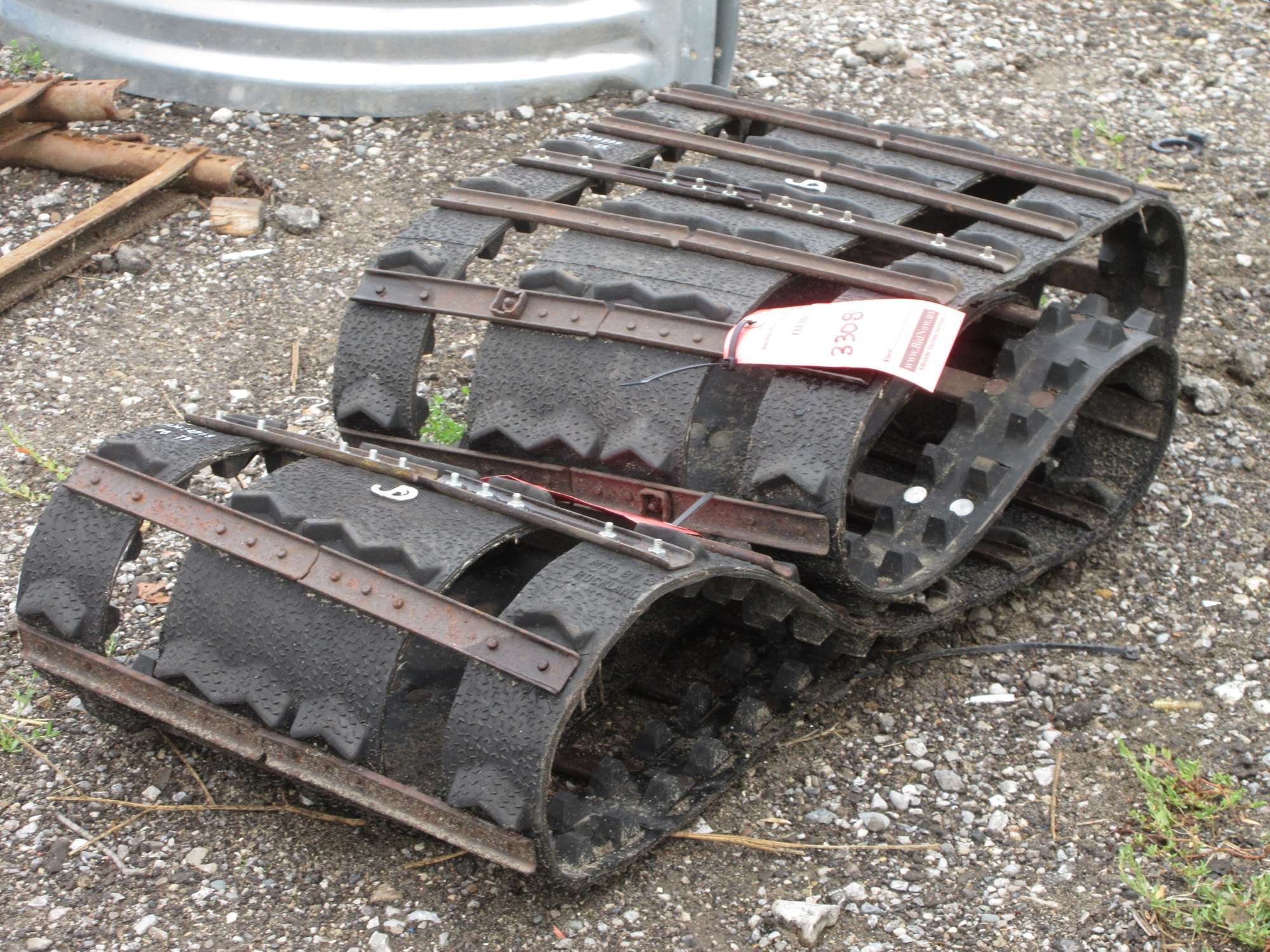

Yep the newer version had a tread pattern change but the dimensions were identical. Had a '79 TF with the old style and an '82 with the new style tread like the one in the picture. The original had straight rubber lugs oriented parallel to the direction of travel if I remember correctly.
Re: Reproduction Fire Series Tracks - AM54969
Didn't scroll up all the way....my 79 had a track like the first picture....

First, the guys got it right. AM54311 was the 78-79 Spitfire and 79 Trailfire track. It is 100% interchangeable with the newer AM54969 track you plan to reproduce. AM54969's claim to fame was that the Chevron lug was actually taller than the cleat for improved traction and reduced cleat wear. Deere actually patented that feature. However it seems that good ol '311 was made out of better rubber and is less prone to cracking and dry rot.
The AM55269 was used on the 81 Sportfire and 81-84 Trailfires. The only difference from the AM54969 is that the AM55269 outer track belts are slightly wider for better floatation and maybe improved strength. However, the M54969 would be totally interchangeable with the AM55269 track, but the wider AM55269 does not fit into the direct drive sleds tunnels. So the track from the 81 Sport and 81-84 Trailfire does not fit the 78-82 Spitfire or 82-84 Snow and Sprintfires. Oddly enough, Deere produced two different cleated tracks from 81-84, but they used the same cleat.
As long as you reproduce the original width AM54969 style track in rubber, it will fit the all the 78-84 Spit, Sprint and Snowfires and the 79-84 Trailfire and 80-81 Sportfires.
