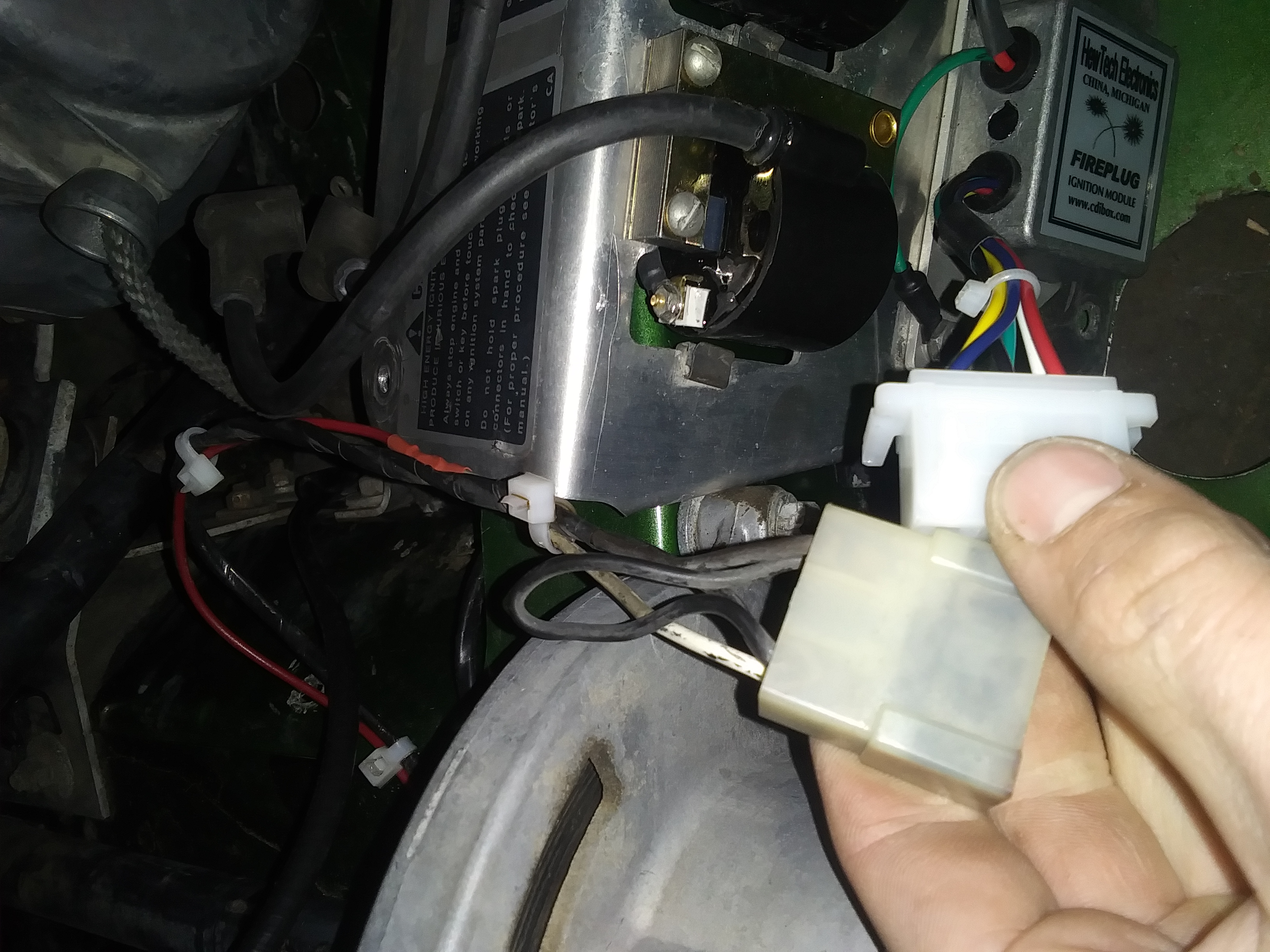

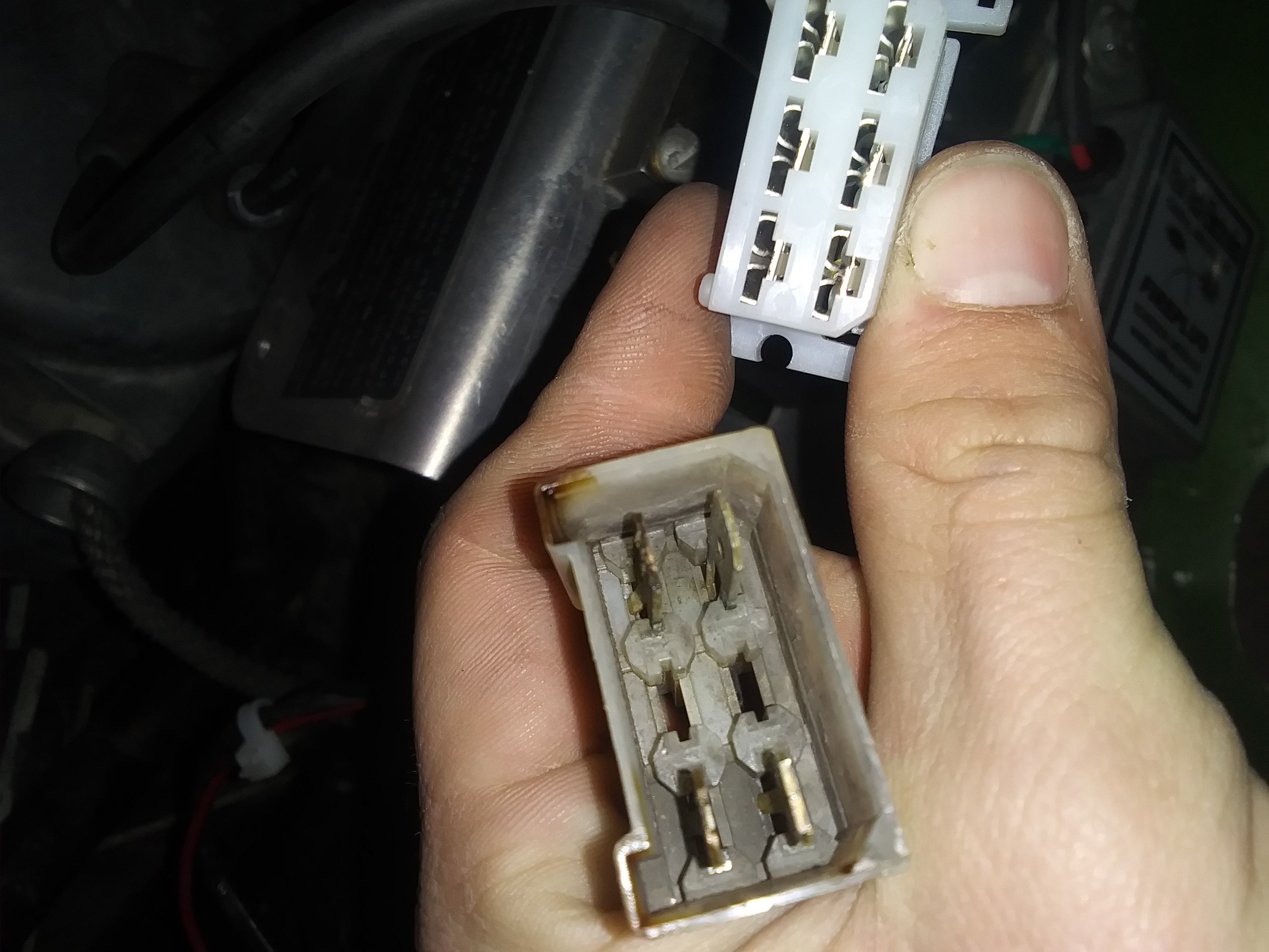

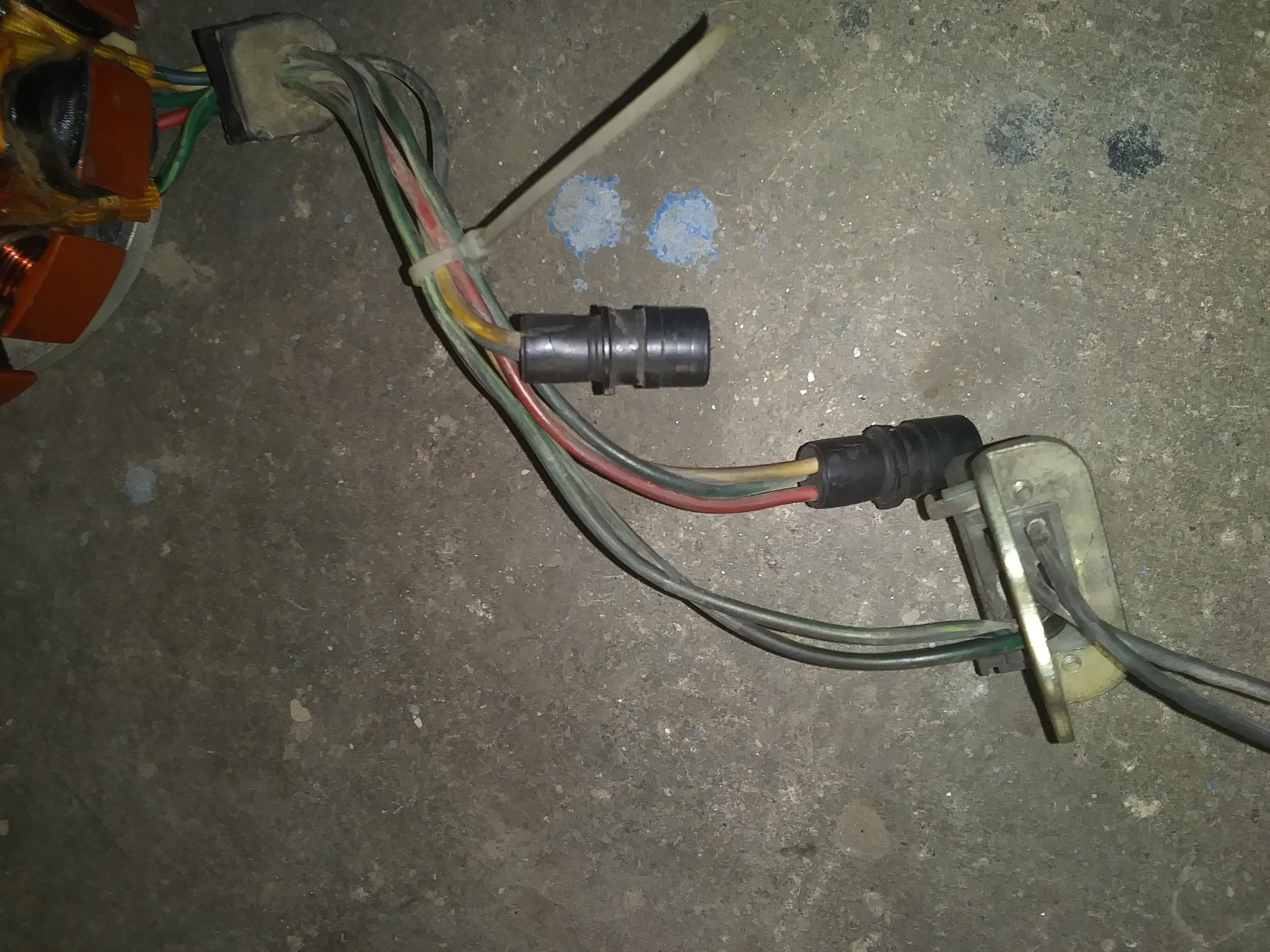

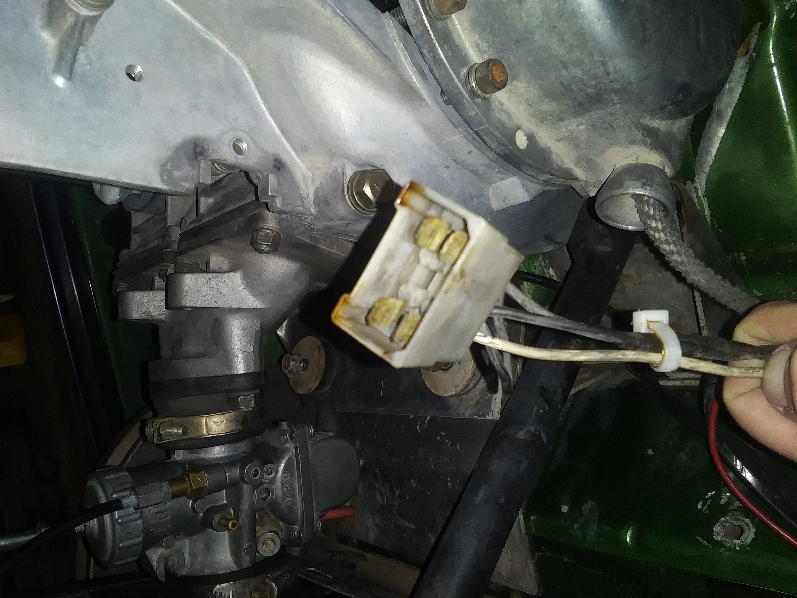

Thanks! I received the fireplug cdi a cupple days ago & it's missing 2 plugs the square plug is correct but the two round ones are missing has anyone else had the same problem?
Re: $100 barn find cyclone
The hewtech box has a plug for the 76' style engine, which has two square plugs, one for the cdi, one for the hookup to the rest of the sled. The square plug of the hewtech is meant to plug into the round connectors only. The existing square connector on your sled is not meant to directly plug in to the cdi.
So, a bit of butchery is necessary to mount the hewtech to a 77' with its round style connectors. Could swap the round plugs off the old cdi, or buy the other half of the square connector and solder that in place of the round plugs on the motor.
What I did is buy the other end of the square 76' style connector from hewtech, then chop the round connectors off my old cdi. I soldered these together, making an adaptor to convert from 77' round connectors back to 76' square. So, running either style box is a plug and play process if I ever need a replacement and it has a different style plug. Not sure if this is the best thing to do though lol
