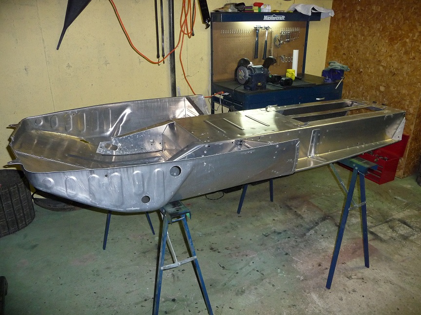

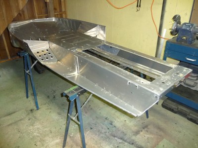

Well the sled is completely disassembled and I finished removing the paint from the tunnel.
The clean-up process begins....

Re: My latest barn find
Looks like you got the easy part done!
Good luck and keep the pics coming!
Very nice work. How did you remove the paint?
