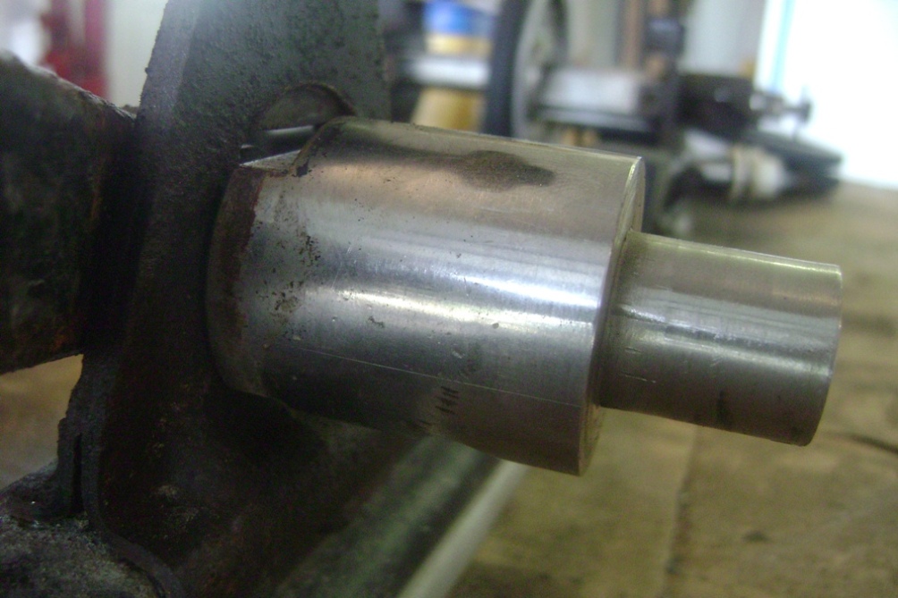

Re: Swap meet suspension

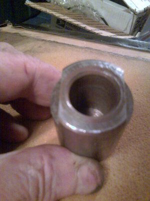

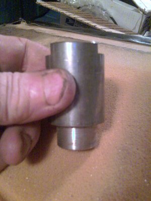

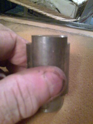

Kenny's photos of the CC side wheel spacer. These fit into the tower.

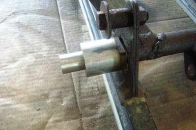

Is this what you are talking about?

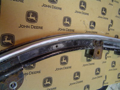

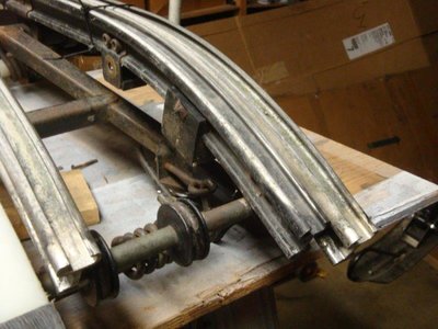

harleysportster wrote:Brian,
Can you compare the front curve and length of the CC rails to the 78 standard rails you have.
The two rails are the same length, and have the same curve. Everything is bolted or riveted on in a different location, and the rear axle is located differently to accommodate the two different tracks.
lined up at the cap bolts
rear alignment
rear alignment
axle brackets
axle brackets

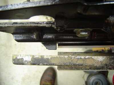

Thanks for the pictures. Here is a picture of a 78 standard rail along side of a 80 rail. I have not inspected my conversion yet to see how it handled the HOF ride.

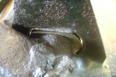

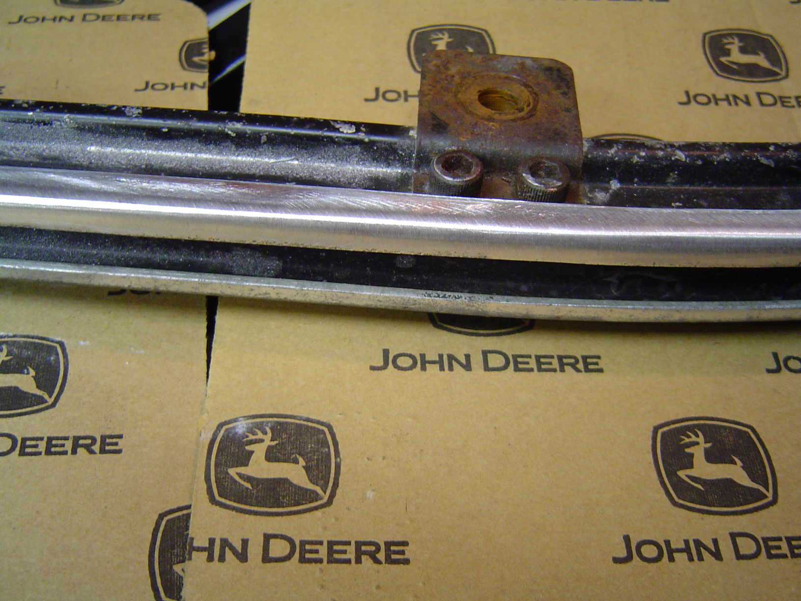

Got the rail back from the machine shop on Friday. It is all welded up, and looks pretty good. Stand-by for photos.
Ok, here we go:
I talked to the owner of the machine shop, never got to talk to the aluminum welder. He thought they could repair the rail as long as it wasn't any strange alloy or had zinc in it. I told him that it was made out of "unobtainium", and that it was a rare CC racer rail. Otherwise, I'd have tossed it in favor of a different rail. He told me that his welder would have to be "in the mood" to do this job, to which I replied; oh yes, I want him feeling it! :laugh:
They had it close to a month, but I finally got the call that it was done. I don't know anything about welding aluminum, I don't know how he did it without burning through the worn spot. Heck, the paint inside the rail isn't even cooked!
Anyway, here it is:
Well worth the wait. Looks great!
