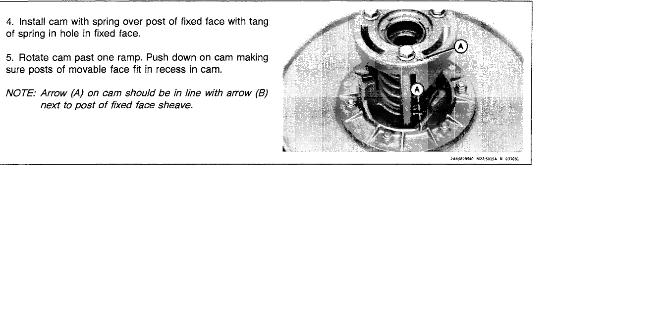

What is the correct way to preload it? The book is vague, it just says to turn it past the proper ramp by one and lock it down. It doesn't even say which way to turn it.

Rotate the cam clockwise.

Thx harleysporster, after reading that again I think may have wound it past an extra ramp. The clutch is hard to work on when on the jack shaft. It would be nice if the clutch would fit on after assembly. I have the spring in position 1 now but I think I will have to put it back in either 2 or 3. Going out for a rip shortly to see how it performs

Thx again folks. It still isn't working I've tried this 4 times now. I have the spring in hole 2, limit spacer is in, helix turned clockwise to the ramp, posts are seated and its just lousy. All I did was replace the part with the plastic slides. This machine performed like a top until I did this. When I first get on the pipe it revs 8000rpm and pulls hard. When it tries to back shift it's delayed and when it does back shift it drops my rpm to 6000 and its a dog! I do not understand what is going wrong. I have taken it all apart, double checked everything and reassembled 4 times now. According to the book my symptom is that my spring is wound too tight causing a too high of a ratio and drops rpm. I have tried 1-4 on e adjustments and there is no change whatsoever. The only thing I can try is to not wind the helix to the next ramp, but if I do this the secondary barely snaps back so I'm sure I have it right. What else can I do? Maybe I should just put all the warn out setup back in because it rocked that way! HELP thx!! I've ruined my good running machine and the snow is coming down as we speak!

Re: Getting more out of a 80LF
How about the arrows mentioned in the tech manual, do they line up?

Funny thing is this Trailfire clutch has arrows but not the liquifire one. Wierd. Is there anyone out there that does LF clutching? I'd like to have mine done, or replaced by someone that knows what to do. If the clutches work then I guess next is to do the motor... Maybe it's just plain power loss
