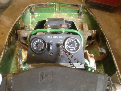

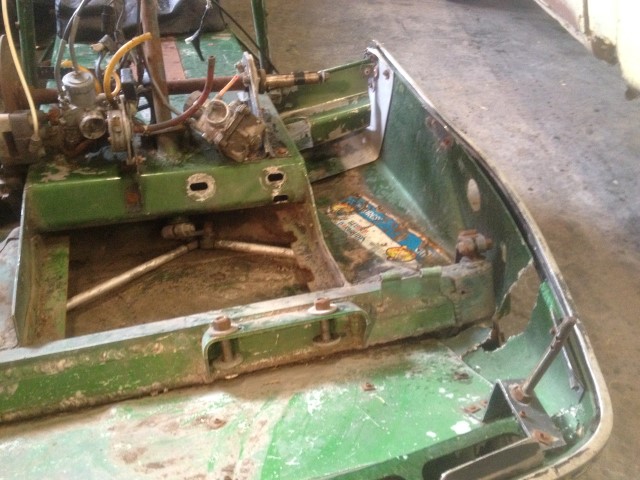

Thanks Joe and Don for the information and the offers I am meeting shaun booth tomorrow in Saskatoon snowmobile show and I'm getting parts from Him and Brian Henrion and Ryan from Ontario said he has a gasket set so I will keep you informed as I am gathering up the parts.I finally got the snowmobilie to the shop today-with all the pieces,The plan was to get the belly pan off and check the frame out but I only got as far as getting the bumper off and taking some pictures.I knew we had done some reinforcing before the I 500 but I was surprised to see how much we had done.I will try and get some pictures on the forms but we're having trouble transferring over to the computer so I think we will try and send straight from the iPad.

The "Peanut Butter" patch probably came during it's absence .
The extra hole beside the motor mount hole looks like a cleat puncture.

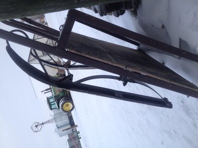

Found more goodies 1 Now I have more questions. Made a sleigh out of a crate frame that JD sleds came in. Does this look like the original ski's & springs for a 340S ? The saddles are ruined from many miles on sleigh.

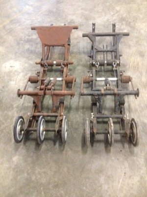

Thought I had a spare suspension for the 340S, the rusty one on the left is the one that came back with the sled. The one on the right I found in a shed, but the front arm is shorter & it has a single shock so am not sure it will fit the 340S. The one on the right can have 4 wheels attached on each side of the slides, which I thought we ran in the cross-country races because of marginal snow in places.

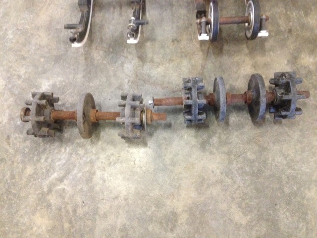

The track drive with the double center wheels came with the sled, will it work on the 2 /3rd's split track? In the parts book it shows only one center wheel .
