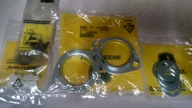

Found a few more new parts available from Deere for the Liquifire project:
24H1862: Center Idler Washer/Spacer
M66125: Jackshaft Clutch Side Bearing Flange
M63775: Taillight Plastic Mounting Nut
M63450: Taillight Mounting Screws

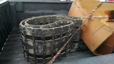

With help from a hauling customer I was able to obtain the NOS Liquifire track from Dustin Smit. Picked it up on my way home from the HoF show. About the only other parts I think I need is a set of repop decals and a low windshield.
Next up is polishing the tunnel and getting the re-assembly started.
