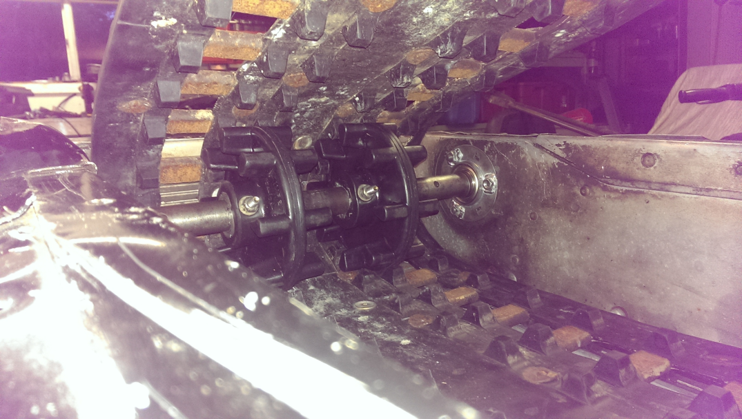

Slow progress. A few weeks ago I got a cheap body work hammer kit and straitened out the belly pan as best as I could (or that I had the patience for).
Today I got the driveshaft done. Big thanks to Harleysporster who sent me a driveshaft with the drivers already freed up and the shaft cleaned. I couldn't get the drivers to budge of my driveshaft and I was just going to end up breaking them.
Mocked up the track, shaft, and drivers, marked the driver position, removed it, center-punched the hole position, drilled the new holes, installed drivers, and done. I don't remember if I mentioned this before but it turned out that this track has the same drive pitch as the original cleat track, but the polaris drivers that were with the track were much bigger and were going to push the track against the heat exchanger. Also, the Polaris drivehaft was longer and was going to require either modification or some spacers somewhere. So the Deere driveshaft/drivers moved in made the most sense.
Re: Lic-A-Dee Split I
Also, you can see Don Amber's bearing flagettes with the welded nuts there. Those are the best things since sliced bread!

Matt wrote:Also, you can see Don Amber's bearing flagettes with the welded nuts there. Those are the best things since sliced bread!
Thanks Matt, sure makes the job easier!!

Trying to get those old paddle cogs to move on those shafts almost seems impossible without ruining them! So do you know exactly what driveshaft Pat sent you that works with that Indy Track?
harleysportster
Posts: 2965
Real Name: Pat Scott
Location: Southeast Pa.
Post by harleysportster »
sledhead16 wrote:Trying to get those old paddle cogs to move on those shafts almost seems impossible without ruining them! So do you know exactly what driveshaft Pat sent you that works with that Indy Track?
I sent him a spare 76 Liquifire driveshaft that was not rusted over badly. I had loosened up the drive wheels years ago. I had to cut off the center idler retainer collars to remove the center idler.

I am not sure how well the round shaft will like having holes drilled closer to the center, but it might be OK. I do have 2.52 hex shaft sprockets that were for the 78 LF 440 update. They would fit a Trailfire hex shaft, but you would again need to drill new holes or make spacers. Holler if you need a set...
