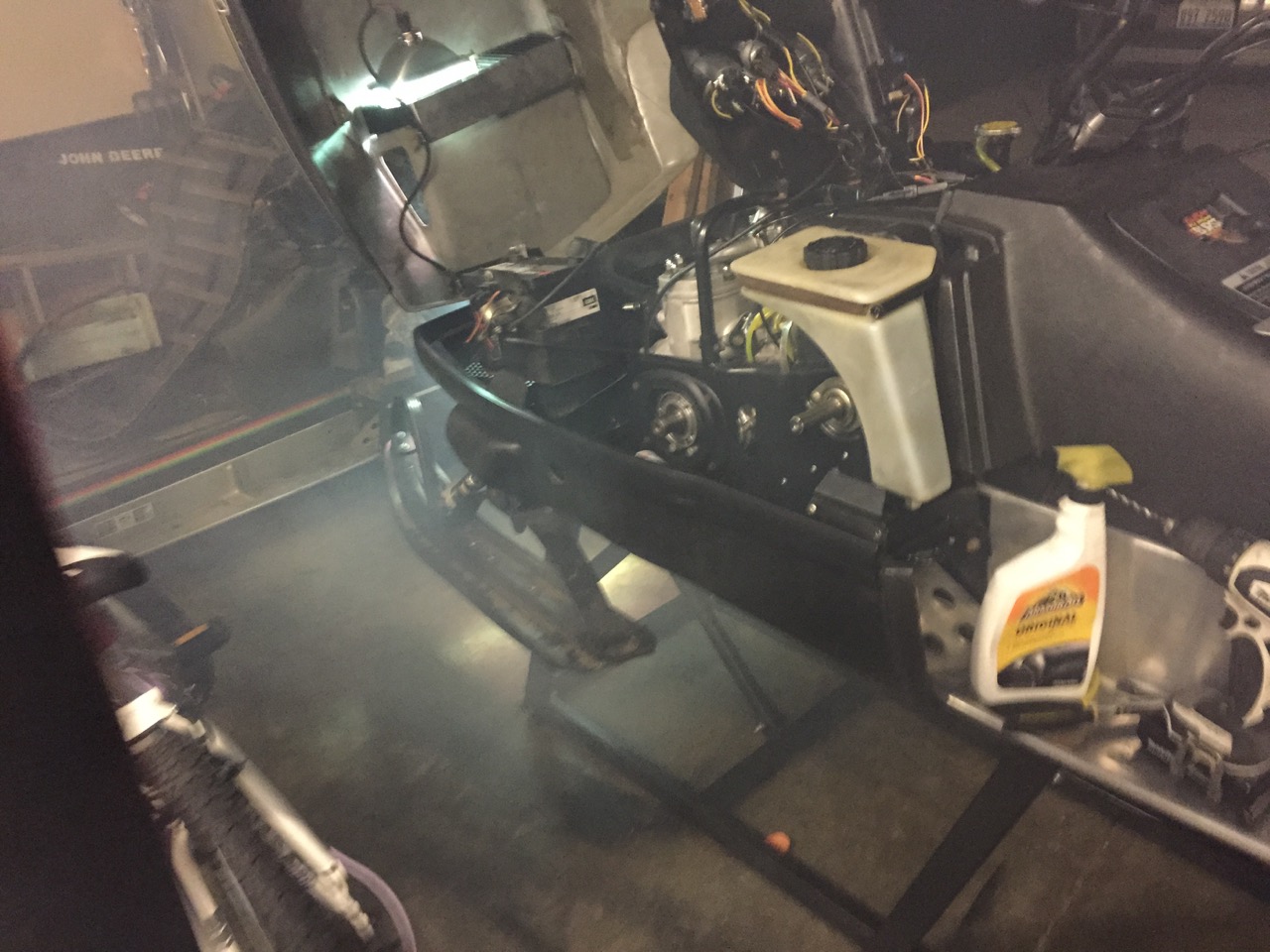

Apparently the younger generation is helping out by attaching the shop vac hose to the exhaust on the 782 Cub Cadet.

Ha, wondering if someone would notice that. Realized he was doing that after reviewing the photo's Its a good garden tractor. I have been mowing with that since it was new :)

cleaned the carbs and put things together. A bit surprised used the 10 year old plugs but fired immediately. It has a rhythmic erratic idle. Starts to 3500 RPM then revs to 5k RPM back and forth no signs of dyeing. Put new plugs on same issue. Both cylinders are firing. any thoughts on what to look for? Thinking of taking the other sleds carbs giving them a good scrubbing and trying them out. have to admit thougth this would not start and would have to fight it. First time complete engine rebuild for me :) :dance: Did have the airbox on when firing. Also all electrical seems to be working just as expected.
