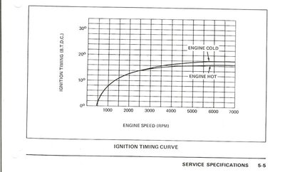

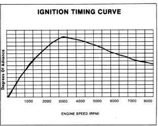

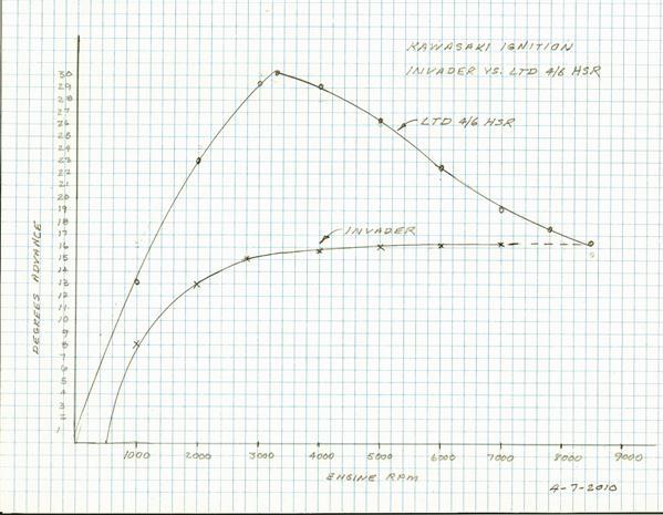

Below are some ignition advance plots scanned from the Kawasaki service manual for the standard Invader (same/similar to 80/81LF?) and the LTD 4/6 HSR ignition (same/similar to the 82/84LF?). The degree increments on the Kawasaki HSR ignition curve are not labeled, but would appear to be in 1 degree increments with the RPM at the mid point of the vertical axis divisions. It is my guess that the HSR ignition was a Kawasaki development which may have applied directly to the 82/84 LF? The last attachment is my rough plot comparison of the two ignition curves, assuming that I have interpolated them correctly?
EDIT: AS PETER POINTED OUT IN A POST BELOW, I DID NOT INTERPRET THE LTD 4/6 GRAPH CORRECTLY FROM THE SERVICE MANUAL. THERE ARE NO UNITS ON THE ADVANCE PORTION OF THAT CHART, I ASSUMED 1 DEGREE UNITS, SHOULD HAVE BEEN 2 DEGREE UNITS. TO AVOID CONFUSION I HAVE DELETED THE COMPARISON GRAPH THAT I MADE ON THIS POST. THE COMPARISON GRAPH POSTED DOWN A WAYS IS CORRECT AND PETER HAS CONCURRED.

Pretty standard ignition curve. They retarded the ignition about 12degrees from 3000 to 8000. Bear in mind the module does not know the static timing of the motor. It only knows to take 12 degrees of timing out. Notice the Invader curve is flat from 3000 on. We do this same curve on tracks with poor traction to stop the track from spinning. Peter

JD Guy. I think you misinterpreted the HSR curve in relation to the Invaders. The HSR advances to about 25degrees at 3000 then retards to about 16. The Invader curve rises to 16-18 and stays flat from there. The earlier ignition timing at lower RPMS gives the HSR more power coming off idle and at engagement. However once at 7000-8000 both are timed similairly. That is why the HSR makes no more power than the early ignition. Peter
Re: Liquifire: 80-81 VS. 82-84?
Peter, I bet you are correct. I was struggling with it after I put it on line, and wondering about a power loss with the HSR at only some 8 degrees advance at 8000 RPM, per the comparison graph in the above post. EDIT: THAT GRAPH WAS INCORRECT AND I DELETED IT. I made the assumption that each vertical division was one degree on the service manual graph for the LTD 4/6 HSR. If you make the assumption that each division is 2 degrees, the graph looks something like the one below, which is the point I believe you made. I had previously looked at 2 degree divisions which results in some 30 degrees advance at about 3000 RPM. That seems huge? The 4/6 service manual graph also leaves some RPM up to interpretation. Probably the best we can make from all of this is an indication of what the Liquifire curves may have looked like (note next paragraph).

Guy. Now you got it! My guess is that both curves would work just fine in an Liquifire. Also, fuel will be the major player when it comes to preventing burndowns. Bear in mind that when you mash the throttle how little time you spend with the timing advanced. Where the trouble shows up is when you are cruising at part throttle (lets say 6500) with an extra 6 degrees of advance in the motor. This is where needle and tubes come into play. This is a very good post. Got anything else for us? Peter

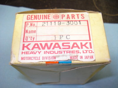

RE: 80/81 LF vs. Invader....Ignition timing curve difference?:
Was there a different Ignition timing curve due to cylinder head and compression differences between LF and Invader? No answer here, but the Kawasaki CDI part numbers are different LF vs. Invader, and the external wiring connections and color codes appear to be identical....suggesting internal electronic differences?
80/81 LF CDI AM54840 = Kawasaki 21119-3001, See photos (2) below of NOS JD part in Kawasaki box.
Invader CDI = Kawasaki 21119-3002 via Kawasaki parts manual
