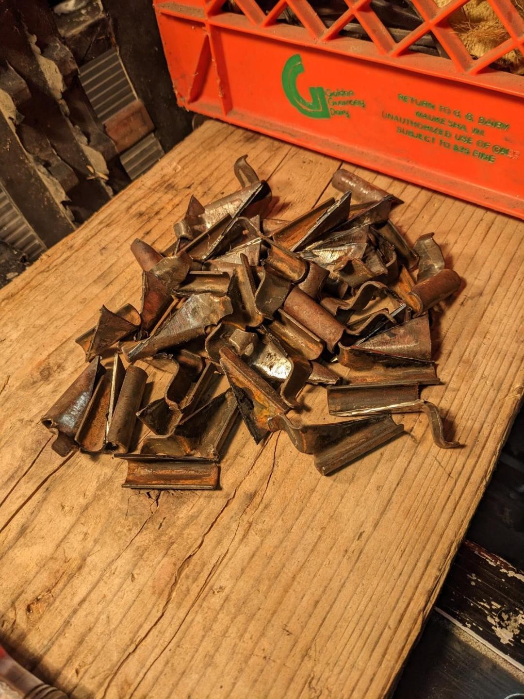

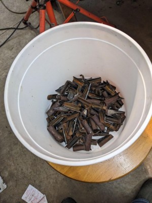

So this is the first track re-clipping I have ever done. It is the first track I have ever owned that has had clips, so this is all new.
I am cutting the clips with a 1/16" disc in the angle grinder. After cutting a few off, I kinda got the hang of it, and I got a lot faster at it.
I make a good pass with the wheel, cool the clip with water from an old Windex bottle, make another pass, cool it again, then look to see where you are. You are trying to avoid cutting into the rubber, and it is easy to do. On most of them, I at least leave a mark. I find it best to not try to cut them completely in half. Cut them thin, then tap a screw driver or small chisel along the groove to split the clip. If it doesn't split, cut a bit more. Once I spit the clip with the screw driver blade, I can pry each half off and pull it out with a pliers.
I have the guide clips off one side now, and I maybe spent an hour.

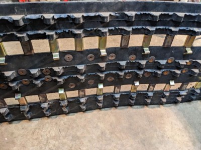

So I started putting the clips on, as usual there is a learning curve. I have 4 on. I quickly identified a couple of issues. The clips kept jumping out of position in the crimping tool. I tried narrowing their spread a little with the hammer on the bench vise so they fit and feed into the tool better and that seems to help. The next thing is that the point in the forming die is cutting into the track. I am going to grind it down a bit and see if I can resolve that.
- Posts: 5705
Re: 78 Liquifire rebuild!
The track is finished! After modifying the forming die in the tool ( I ground most of the point off ) and reducing the spread of the clips before installing them, it all went quite fast. One evenings work to finish up the track.

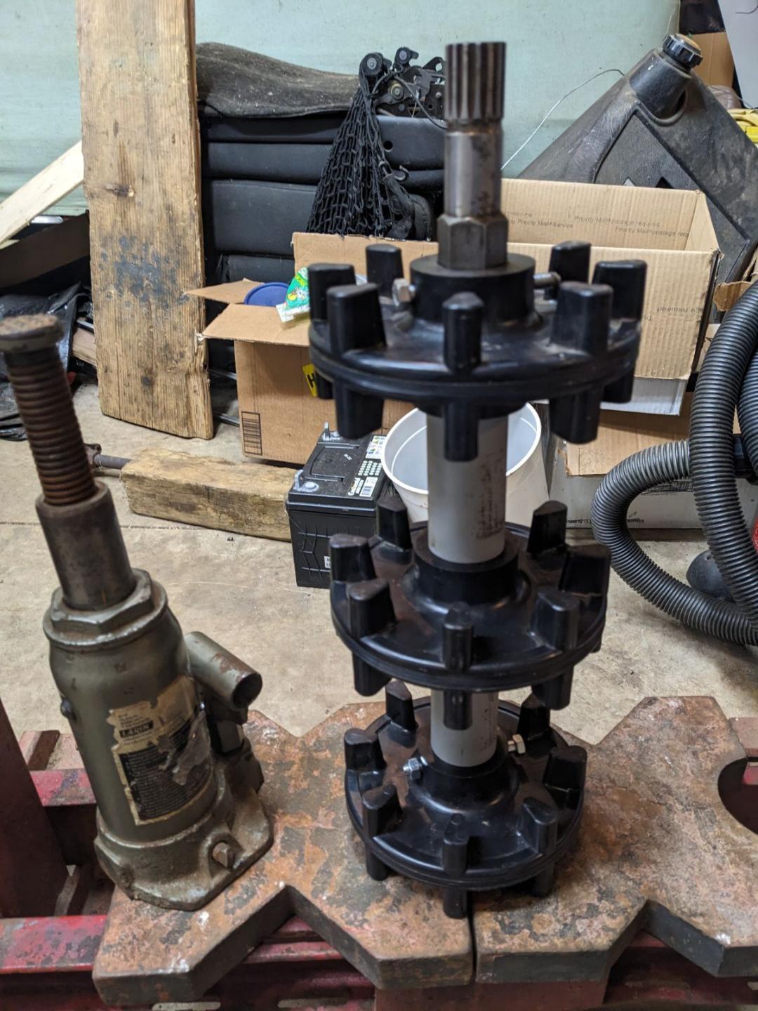

Today I assembled the driveshaft for the sled. The 78 CC used a hex shaft, the same part that was later used on the Liquidator. This was the first use of a hex driveshaft, which was then used on Trailfires, Sportfires, and second gen Liquifires.
The early hex shafts were drilled for bolt on drivers on each end. Aluminum tube spacers were used to locate the center driver, as drilling a hole in the center of the shaft was an invitation to failure. The later hex shafts used a press on driver, so those shafts are not drilled.
Here I am using an early shaft, with NOS bolt on drivers. They are for a 2.52 pitch track. I have pressed new rear idlers on bogie sled axles in the past, but pressing on hex drivers was a whole new experience. I chamfered the edges of the drivers with an exacto knife, and lubed the driver and shaft with a spritz of windex, they pressed on quite easily. Rather than aluminum tube for spacers, I used plastic.
One more item done!
