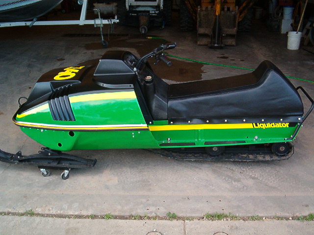

I may have sent these to you before, here are a few side shots of my 78 Liq with the '80 skid and AC track intalled. The only thing I had to do was move the front swing arm mounting holes forward, as per the 78 CC conversion spec sheet.
This is still a work-in-progress, not quit a drop-in swap.
