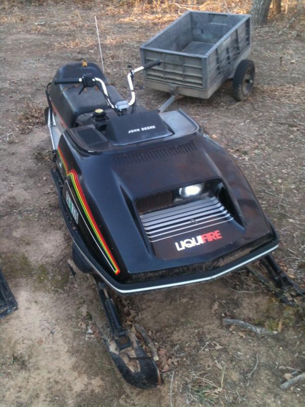

Well this guy was selling a Liquifire here in TX, yep, in TX, where it hardly ever snows. Me being bored I go and take a look and decide for $100, it would be a fun project. It will start but wont rev., guages work, Gas tank is shot, seat needs to be recovered. It was last tagged in 2004 so it did run not too long ago. Come to find out it is a 1981. I also got another sled with this one, an air cooled .....?? Not sure but it is missing a lot of stuff and is pretty much a parts sled.
I have yet to get a compression test on it but I am thinking it needs a new top end. In the meantime I would like to get the gas tank working, carbs cleaned and oil tank removed BUT I have some questions....
Where do you get the rubber bushing that is on the bottom back of the tank where the fuel line passes thru? The hole in the tank is 3/4 inch and the only fuel bushings I find are 1/2 inch????
What kind of oil do you run in these? Would Amsoil Interceptor work? I run that in my 2 stroke quad already.
Is it possible to go premix and remove the oil tank? IF so how is it done?
Thanks for the help, I know there will be many more questions to come!
