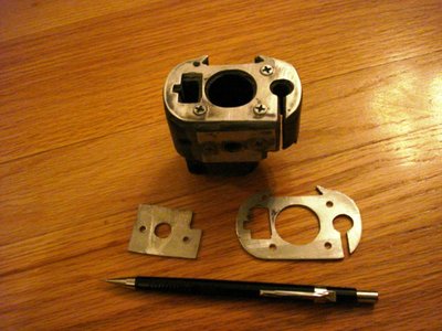

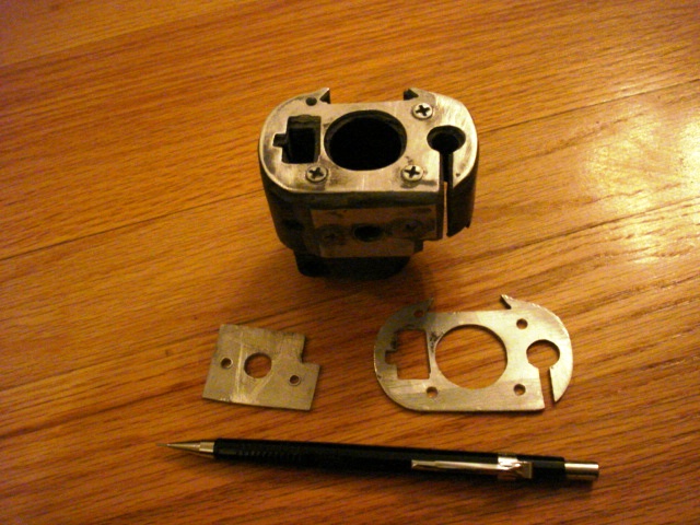

Chuck: They broke back in the day and the survivors break today....either at the set screw or at the thin section just below the kill or bright/dim switches. My fix was glue them (3M Scotch Super Strength Adhesive, 6004)) and then epoxy and screw on aluminum plates. Takes some cut, drill and file. Spray black, not noticeable. Survived two vintage challenges, plus some other rides, so far so good. Sorry about the poor pic, taken some years ago with early digital camera. I don't know this for sure, but I have suspected they don't like WD-40, commonly used for cable and switch lube. Some plastics don't like it and this may be one?? Use countersink head screws.
Guy
