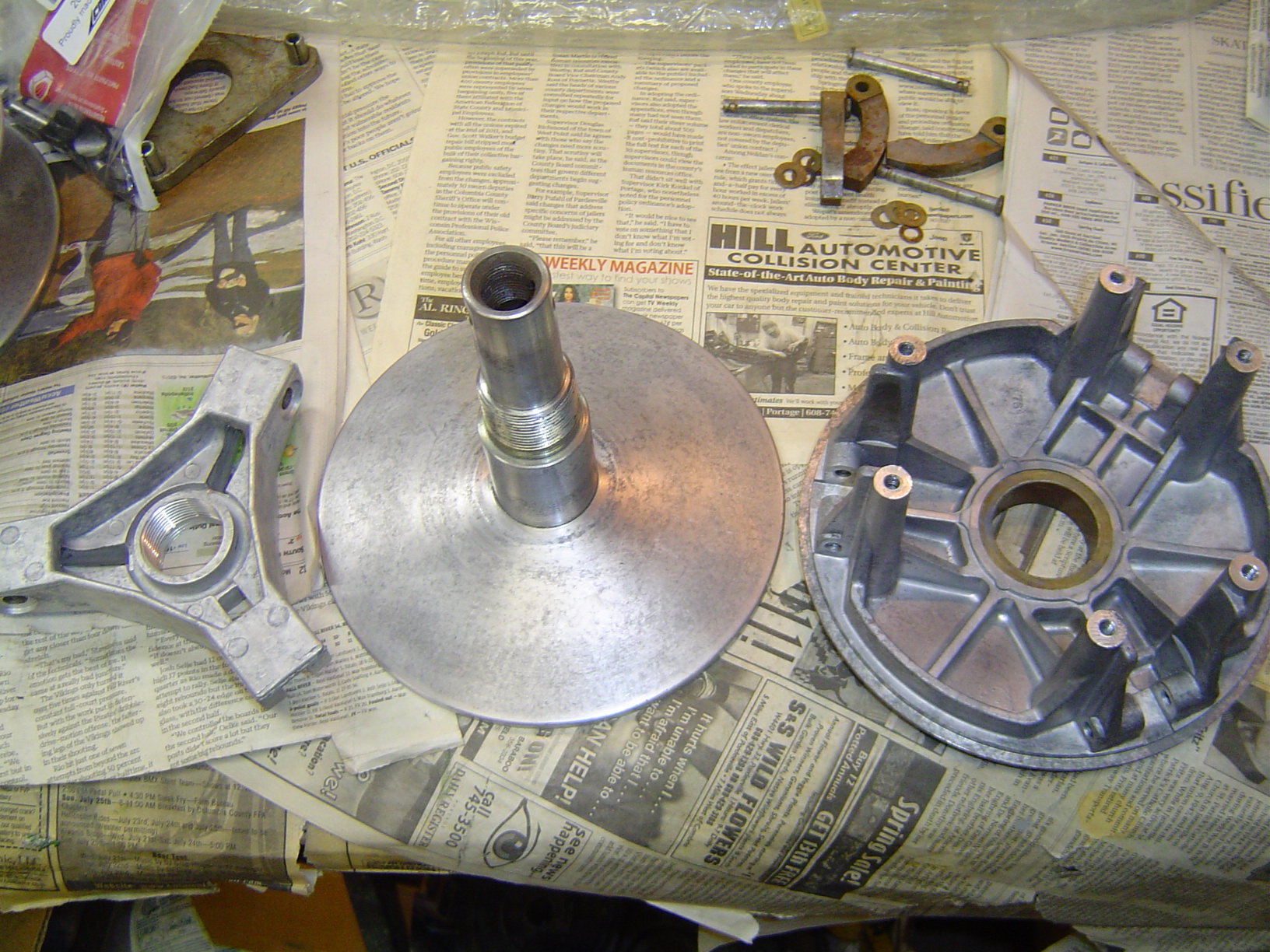

OK, so now for the spider. This too has Locktite in the threads, and you need a spanner tool to turn it off. I made one several years ago, and I have successfully used it on most attempts. But as this clutch was looking like a diamond in the rough, I got my brother's genuine Deere spider tool; JDM 41-3. I have JDM 41-5, which is what you use to hold the fixed shaft from turning.
A photo:

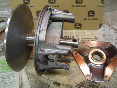

You flip the whole clutch over, and clamp the square "nut" in the vise. Then you warm the spider hub up to melt the Locktite. Once warm, I held the spider tool up against the spider with a big screwdriver, put a breaker bar in the square hole in the tool, gave it a gentle push, and the spider broke loose.
Removing it from the vise, I removed the tools, and spun the spider off by hand. This is a really nice clutch, it is a exact duplicate of the 102 I have sitting on the bench out of my '78 LF. "R" weights, black spring.
There is a bit of rust to be polished off the fixed shaft, the whole thing needs to be soda blasted, and the rollers in the spider have rusted, and need to be replaced. The sheaves are surprisingly smooth, and the bushing in the moveable seems to be in great shape as well.
After clean up, if I swap the "R" weights with the "F" weights in the X8's 100C, I should have a good clutch for the X8.

Re: Lets rebuild a Comet 102C
Great pictures showing how to mount the JD tools. The newer style 102s do not have the hole drilled in end of the fixed shaft requiring the use of the newer style Comet Grunt Tool.
Actually I love my grunt tool and use it even if the hole is present. Highly recommend.

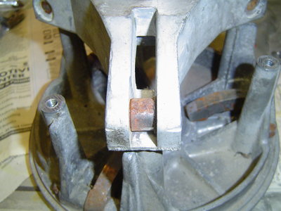

Here's a look a some of the issues.

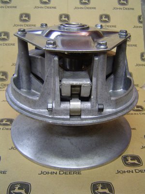

Cleaned up the arms, and re-installed with new washers and bolts. I prefer the bolts, as it eliminates the pesky little roll pins, and the tightened bolt actually ties the towers together, strengthening the clutch slightly.
Installed the new pins, rollers, and buttons, which were sourced from Dennis Kirk.

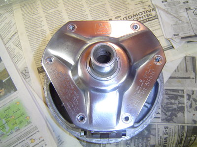

Cleaned the cover plate, and did a bit of polishing. NOTE: this cover is steel! I have edited the 101C thread accordingly. The earlier covers were aluminum, it appears that when they discontinued the can, they switched to a steel cover plate.
Everything is just finger tight at this point, The spider has yet to be locktited and tightened, same thing with the arm pivot bolts.

OK, a 102C clutch is rebuilt and ready to install on the X8.
It has been cleaned, and new rollers, pins, and buttons, have been installed. I re-used the arms out of the 100C that came off on the X8, but they were installed with new pivot bolts and washers.
