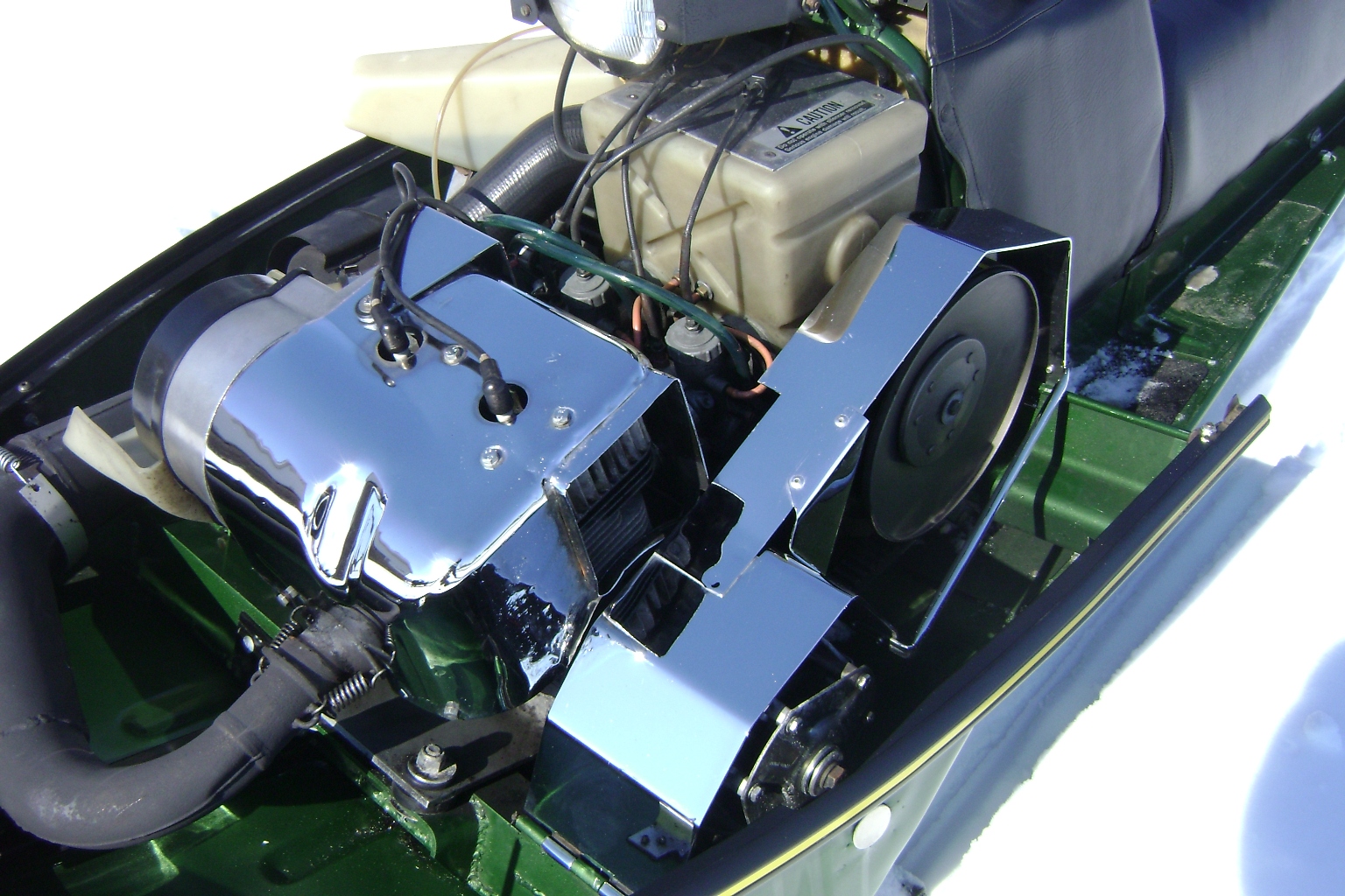

Chrome
Re: 340s paint and restore
:eh:

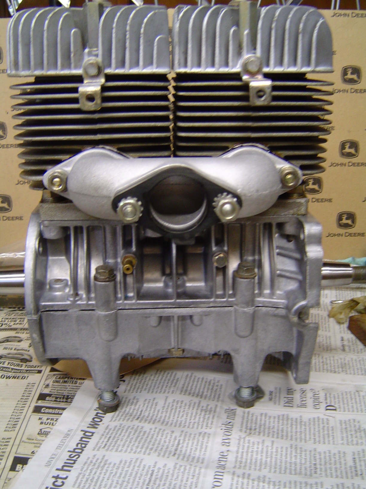

Soda blasting makes many of the aluminum parts look great. You do not have to spend a lot of money to do it either. A hand held spot sand blaster may work just fine with bi-carb, that is what I use. Engine cases really clean up nice with soda, other parts might need a little polishing to look good.
Here's a shot of my '72 engine. The jugs were NOS, so I didn't blast them, but everything else was.
