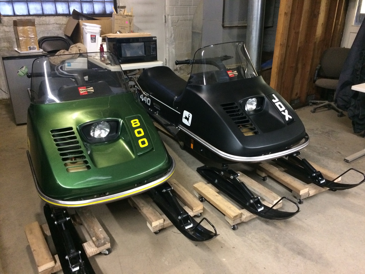

This sled will be a nice partner with my 800.

I know what you mean about the pair.... They do look great together!
