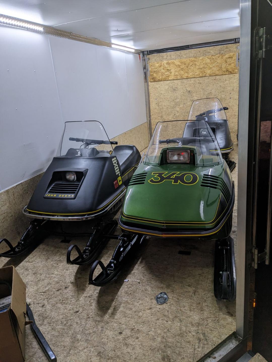

Our trailer still had the sleds sitting in it just as we had shut them off since last years trip, so I hooked on to it like normal.

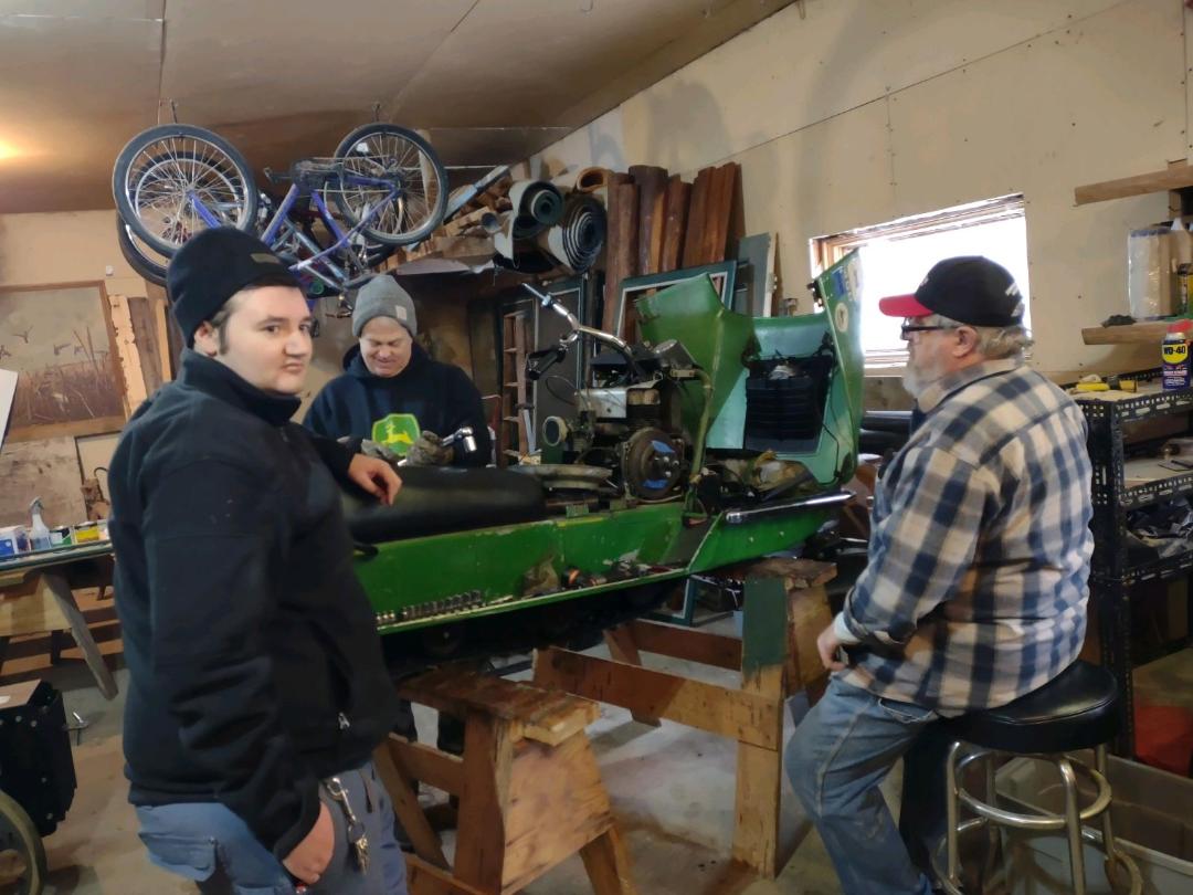

The photo in the middle is of the garage we work in there at the Motel.

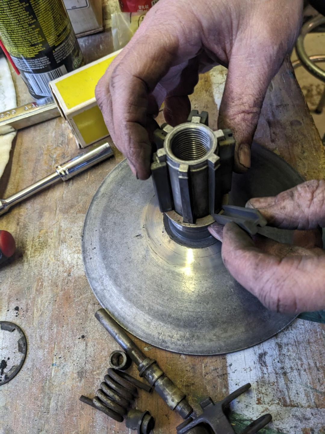

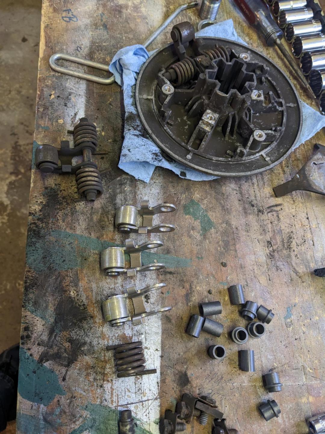

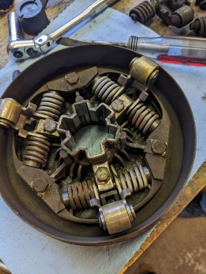

We got out into the garage late in the morning. Joe removed the Salsbury clutch and disassembled it on the bench. The recoil and cup were removed off the engine, and I dropped the dial indicator down the plug holes. After installing a wire pointer on the fan tower, I stuck masking tape on the flywheel and began putting on timing marks. Rainville had been procrastinating checking the timing on this sled for years, today we were going to find out where it was.

Nick, Wade, and Tom showed up to stir things up. Tom had a box of NOS Salsbury parts with him. Joe could not find a new set of rollers before he left Texas. The ones I had in my stash were stock for the 73 JDX4, and high altitude for the 300. Between Nick and Tom, somebody had the correct rollers springs and bushings, but no one had NOS plastic slides. The ones in the clutch looked perfectly good anyway.

Back at the garage we cleaned the clutch parts with carb cleaner and started re-assembling it. Getting the coil springs pulled back into position is a bit tricky, but by the time he got to the last one Joe was getting it figured out. I wanted a quiet garage to check the point gap with the new feeler gauge, so we knocked off for the afternoon.

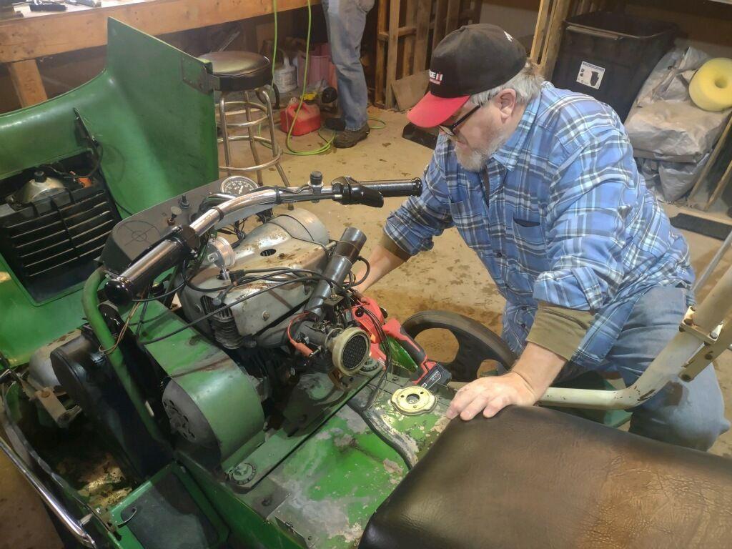

Back in the garage, I was looking at the sled and wondering why Joe had not brought the lift? About that time Wade, Nick, and Tom came in, and they picked the sled up while I slid the saw horses we found in the garage under it. This was much better! The clutch was re-installed onto the engine, which just left the timing situation to be resolved.
The question was; why are the two sides so far apart? I tried adjusting the point gap to compensate, but it was too much. At some point Dave and Andrew Clark came in, and Wyatt and Roger Kram also were there. Guys came and went, but at one time there was nine guys in the garage. Neither Joe nor I ever left for lunch, I had Katy bring out a can of soda at one point.
Jason Peterson spent the day ice fishing on Big St, and Katy walked the 2 miles up to the cabin to visit with Mindy. The paved bike trail along the road made a good walking path. We had gotten 2" of snow Wednesday night, so at least it looked somewhat normal up here now.
Back on the sled...It appeared I was going to have to rotate the breaker plate, but the screws wouldn't budge. Joe had removed the plate a few years back when he had replaced the crank seals, and I accused him of putting them in with green Loktite. Joe beat the heads of the philips head screws flat with a punch or 1/4" extension and they finally broke loose. On my own sleds I like to replace these with socket heads to get a better grip on them.
With the screws loose, I found I could move the plate only a small amount. I remember having the same issue with my 72 400, there is such a wad of wires coming out the back side of the plate that it interferes with movement. To resolve this was going to require removing the fan tower and flywheel. This was following a familiar pattern...but in for a penny in for a pound. My genuine CCW flywheel puller was in my tool box, so as soon as the tower was off, it was installed and the flywheel was popped off. Joe had removed the flywheel nut with my cordless impact and a SAE socket, as my 22 mm socket was not in my box for some reason.
We examined everything closely. There was nothing obviously wrong under the flywheel, the points looked very serviceable, the cam on the flywheel was good as were the rubbing blocks on the points. The screws were removed from the plate, the wires were relocated a bit and the plate was rotated from the screws being in the center of the slot, to being in the most advanced position. The flywheel was put back on the shaft, but when I went to put the nut on, I found it would not spin on easily at all. The threads on the shaft were clean, the nut looked good, I tried each side of the nut, but after 1/4 turn it would jam. I asked Joe if the nut had come off hard and he replied; "yes, all the way".
I don't believe I have ever had messed up crankshaft threads before, and when I had pulled the flywheel off it had not put up much of a fight. Wyatt thought the threads were rounded a bit, so he dressed the threads a bit with some small files Joe had in his box. Eventually we called it as good as it was going to get and screwed the nut on. Back to checking the timing...I now found the retarded side to be pretty close to where I wanted it. Roger and I messed with the mag side points until we got that in about the same spot and declared victory!
