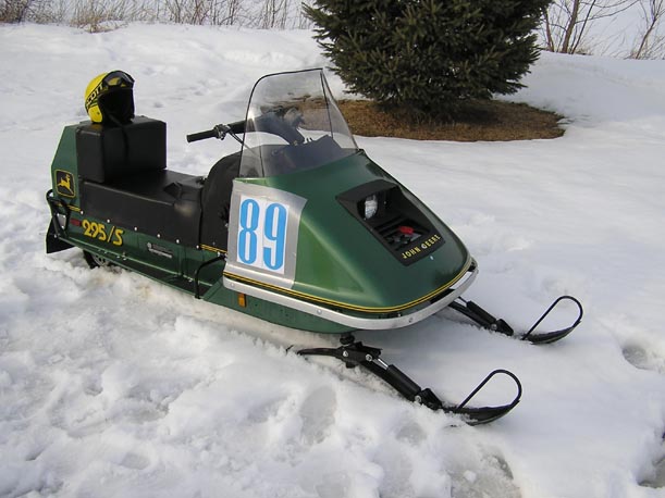

    This 1974 295/S is owned by Jim (75rat in the forums).  It was the 10th one built, and was raced by the Deere factory team in the 1974 Winnipeg-St. Paul I-500.  It was ridden by Jim Dano (#89) of Nisswa, Minnesota.  He was running in 37th place (out of 282 sleds) when he collided with a car that wandered on to the race course and put him out of the race.  After that, the sled was taken back to the factory and rebuilt.

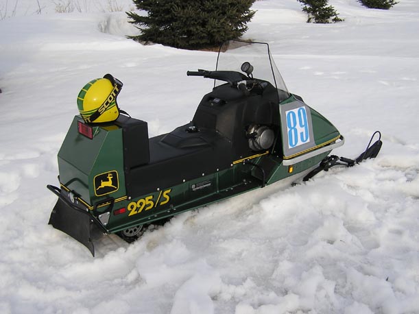

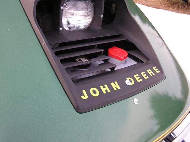

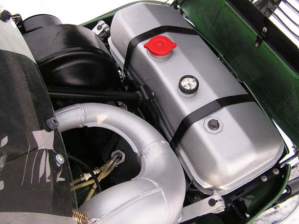

    All the changes were done at the factory when new.  Among the biggest changes are the fuel tanks.  This machine never had the standard production tanks (2.5 gal or 5 gal).  In the front, is a tank that looks standard, however has an extra 2" section added, raising it higher, and this is what pushes the filler up through the grill.  There is a custom tank built into the belly pan, which is connected to the front tank with a 1" dia. pipe.  As you can see, the fuel pickup comes from the lower tank.   There is a skid plate to reinforce the belly pan.  There is yet another custom tank under the seat, between the rider's legs.  There is no fuel storage in the backrest.

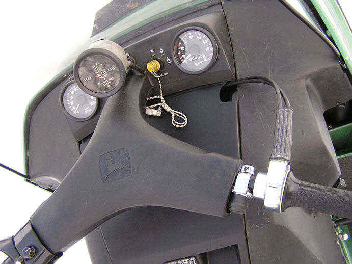

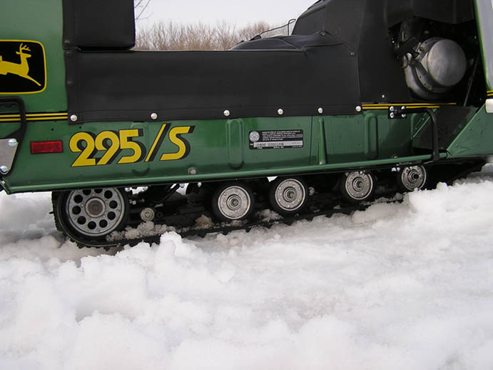

The rivets you see secure a bracket that keeps the fuel door closed. Control modifications include hand warmers on a fused circuit, twist grip throttle, a cylinder head temperature gauge, and a dash mounted tether switch instead of a key switch.
    Chassis modifications include a bogie/slide suspension with studded rubber track, moved footrests, stirrups, high windshield, backrest and custom seat.
