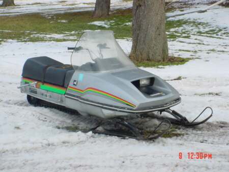

This isn't a restoration, but a good project for someone who wants to ride on a budget.

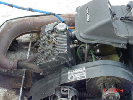

      I picked up a nice John Deere Trailfire LX which had a blown motor.  I went to my nearest sled graveyard, and picked up a decent looking 340 Liquifire motor, by Kioritz.  They wanted $200 for it, but I only had $150 so they took the CDI off and sold it to me for $140.  A friend told me that this motor would mount right up,  it did not, so I had to redesign the mounting plate.  I did that and got it to fit.

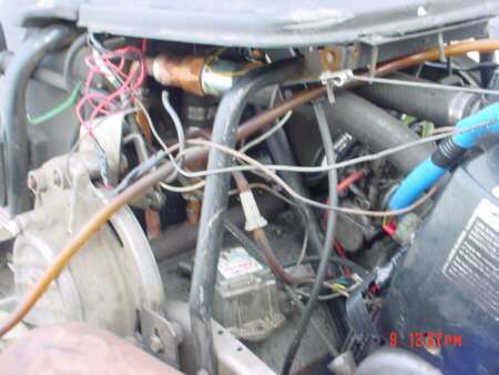

Now the next problem, no CDI.  I went back to the scrap yard, and all they had was the type "B" CDI, not type "A".  I guess the difference is one has a square plug and one has a round plug.  I needed the round one.  They didn't have any more round, so i got a square model, and did a little splicing.  I just put male slide connectors on one end and attached it together.  I started it, and it ran great!

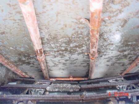

But now the final problem, no heat exchanger.  I had to come up with an idea.  I had a heat exchanger, but it was too large, and running the hoses would be difficult, so i came up with another idea.  I went out and bought some copper pipe, and made my own heat exchanger, and it works great!

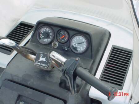

 No leaks, and it stays cool.  I added a temperature gauge on the dash to be sure.  The sled is suprisingly quick!  It goes about 70 right now, and I love it.
