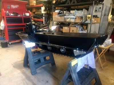

Progress on the JDX inches forward. Even RJ has come out to shop to lend Dad a hand.
5 of the 6 sets of bogies are now installed, with last set being left out to make room for the rear axle installation.

Despite life getting in the way of any QGT (power steering lines on the Chevy, during which the hot water heater went out too), I was able to sneak a few minutes here an there to make some much needed progress:
After picking up the replated NOS rear axle parts, I laid everything out for final assembly. I have had the new large washers from Deere replated silver as they came gold and didn't look right. Lindner was kind enough to provide repop inner bushings and retaining axle bolts earlier this year. I had already blasted the painted the NOS rear springs when I did the bogies springs earlier this summer.
It's kind of nerdy and really no big deal, but that entire rear axle assembly mostly NOS parts, with a few new pieces like the bearings and hardware with the reproduction bushings from Brian. There are no used parts in it at all. I only had enough parts to build one complete assembly, so I figured this was as good a use as any
- Posts: 4355
Next step was the bolt the back half of the rear axle over the track to the rolling front half. I finally got to use the flat head screws that were a small pain to find. This was why I left the last set of bogies out, to leave room to work around that axle.
The final step of bolting down the rear axle was a bit of a pain, as that nice new NOS track was tight and needed a little help from a ratchet strap to get the axle far enough back in place to get the bolts in. After that it was almost a pleasure to FINALLY bolt in the last set of bogies.
Again, it's no big deal, but its really a good feeling to be putting all these NOS parts to use finally. The only used parts in the suspension are the replated inner bogie shafts, half the carriage head bolts, the bushings inside the bogie springs and the some of the clips. Everything else from the chaincase to track, axles, bogies, bogie tubes, springs, etc was NOS, plus new parts from Deere like bearings, nuts, bolts and washers where appropriate. I think I had to buy bogies from about 4 or 5 different collectors to get a set of 15 NOS ones. Thanks guys
- Posts: 4355
I called Cari Deerest into the shop to lend a hand flipping the X-8 over (don't worry, I gave her the heavy end, LOL!).
From there the hood latches went in, and I started back on the top of the chain case and installed the brake drum and new JD brake band.
It's nice to have the work bench back cleaned off, as I have a few Mikuni's to clean up for other projects due this weekend
